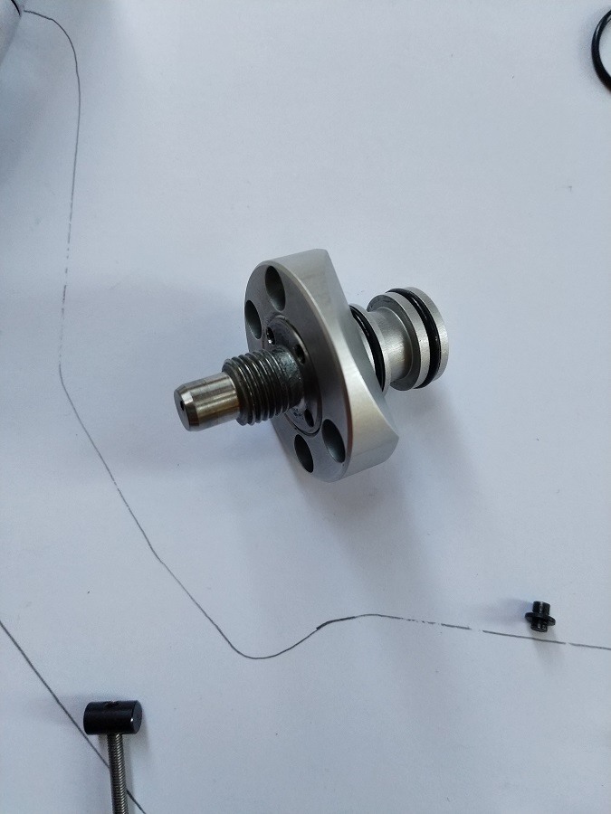

So I've had to take mine apart for some cosmetic work, and I've run into something like an answer for you. Take off the valve at where the air hookup is. It's the 4 bolts surrounding the air attachment. Pull the whole thing straight out of the frame and look at the back of it. There's a grub screw at the back that is an M5, I believe. That seems to be the air pressure adjustment. I figured this out when I took mine apart and the gun shot super weak when I put it all back together.
Mine works by screwing in that bolt all the way IN until your hex wrench slips and won't turn anymore. It's a hollow screw and there's a post inside the valve, which is why you run out of purchase.
My picture doesn't show it, but it's the screw on the back of the shaft with the two o-rings.
