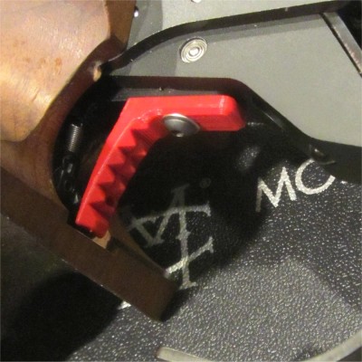

I now have "Sensiv" triggers on my MatchGun MG2, my Anschutz LP@ air pistol (rebranded Steyr LP-10), and my Morini CM84E free pistol. I ended up using the 3-across by 6-high version shown earlier on both the MG2 and the LP@. They are no miracle cure, but I think they help:
With the free pistol, the trigger pull is so light that there is very little feeling, no matter what I do. I doubled my trigger pull from 50 grams to 100 grams, and went with a coarser pattern:
It's hard to see, but there is a hole in the lower left so the optical safety works.
I think it helps a tiny bit, and it certainly doesn't make things worse.

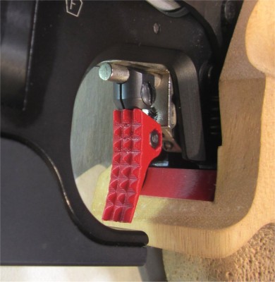

I made one for my free pistol, with a single pyramid, and cranked the trigger weight up to 100 grams. I think it definitely helped re-establish some feel for the trigger. Now I just need to practice getting my shots off smoothly and quickly, before my eyesight fades and the shakes set in...
