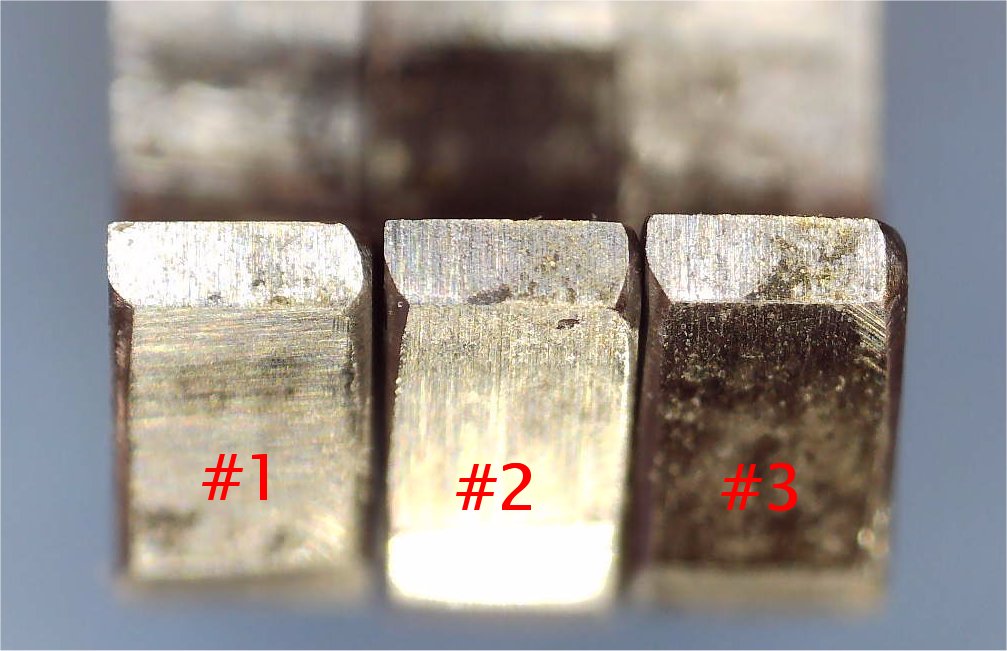

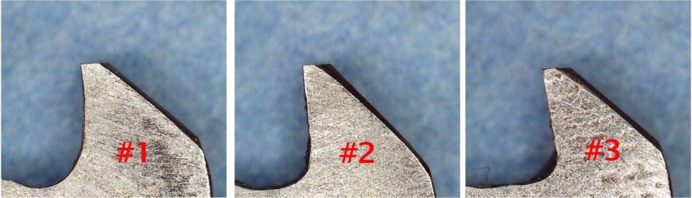

I'm still studying the optimum extractor design for these things. I have have examined 3 examples that work flawlessly. And then there's my first MG2... My best guess is that your problem could be fixed by a properly fitted extractor, but just getting a replacement part won't do it. All the ones that work well have been modified by hand at the factory, AND they started with parts that have more metal in some useful places than the replacement extractors I've received.
Based on the latest EVO I have (which works great), the current extractors they are starting with at the factory are "shorter". You definitely want the gap between the back of the extractor tip and the face of the slide to be ~ 0.15mm (0.006"). If the gap is too large (your extractor is too long), you can fix it with a shim in the back, but that requires some fussy mechanical inclination.
I've been doing some experiments. I had extractors that were all virtually identical to the naked eye (all of them require shimming to get the gap small). One worked great for a while, and then started jamming. One was re-ground from an old extractor, and it was even worse. On the third one, I started with a new extractor, and carefully ground and polished it as best I knew how. It worked fine. Even under a microscope, I couldn't see what the critical difference(s) were.
I think I've figured out what is going on, but I need to do some more tests. I've found Aguila to be fussy, and I have lots of it, so I test with that. Even if I can fire my typical 60 round test without a jam, it's important to know how many cases are bouncing out of the pistol by hitting the bevel on the right hand slide rail. I coat that with black marker before each session, and then count the hits under a microscope when I'm done.
I need to go through my notes carefully, reconstruct things in detail and make some drawings, but here's roughly what happened:
I adjusted the angle of the tip on extractor #2 by ONE degree, and went from five jams down to one (in 60 rounds). Another degree, and the jams went away, but I was still seeing that cases were bouncing off the slide rail occasionally. Another degree, and the hits on the slide rail were reduced and moved higher. Another degree, and the impacts on the slide rail vanished.
I have a fourth extractor I hope to test tomorrow that I'm trying the same adjustments to. If that works the same way, then I will write it all up.
