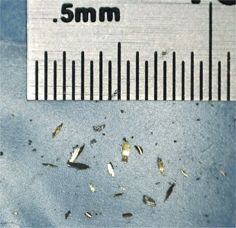

I have an odd issue in that somehow my SP is shaving bits of brass and they're ending up in the trigger mech, probably around the transfer bar, and causing a grungy feel until they're blasted out.
Its not an issue on my RF and I interchange magazines so I don't think its that, must be the barrel or slide, but still can't find it.
Posts: 3531
Re: pardini sp trigger reset is very slow
I've had problems with various ammo dumping brass bits in my pistols. The problem is caused by mis-adjusted crimp dies at the factory. Instead of folding in the mouth of the brass arounds the bullet, they are set too far back and cut into the case, leaving burrs that can detach. Here's what I fished out of my MatchGun at one point:
Here's what a really bad round looks like:
This was with some Aguila, but I first ran into it with a particular lot of Eley Target. I contacted them, and their response wasn't even particularly apologetic. They said that it was an older lot, and they check their machines regularly to make sure it doesn't happen.
