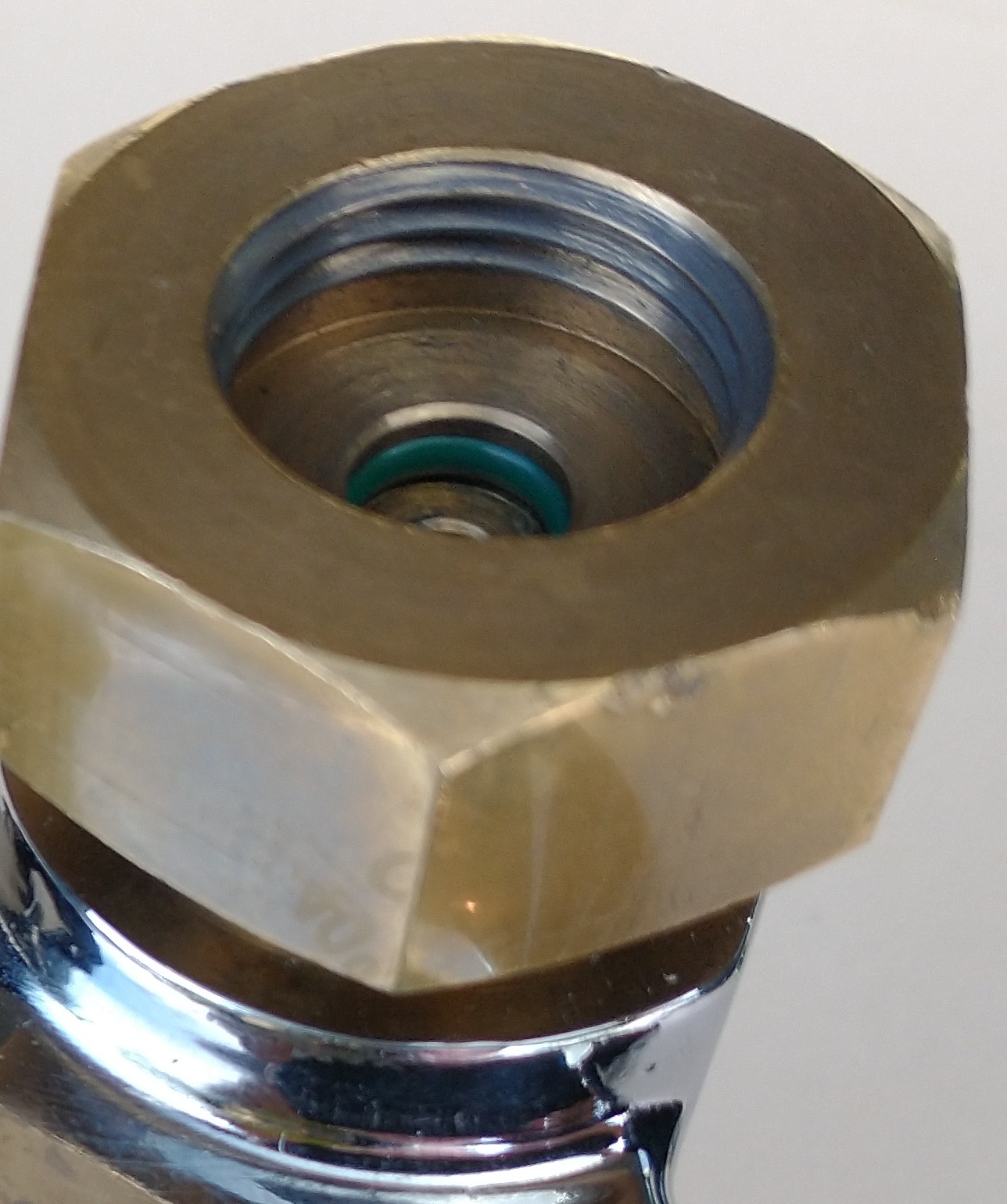

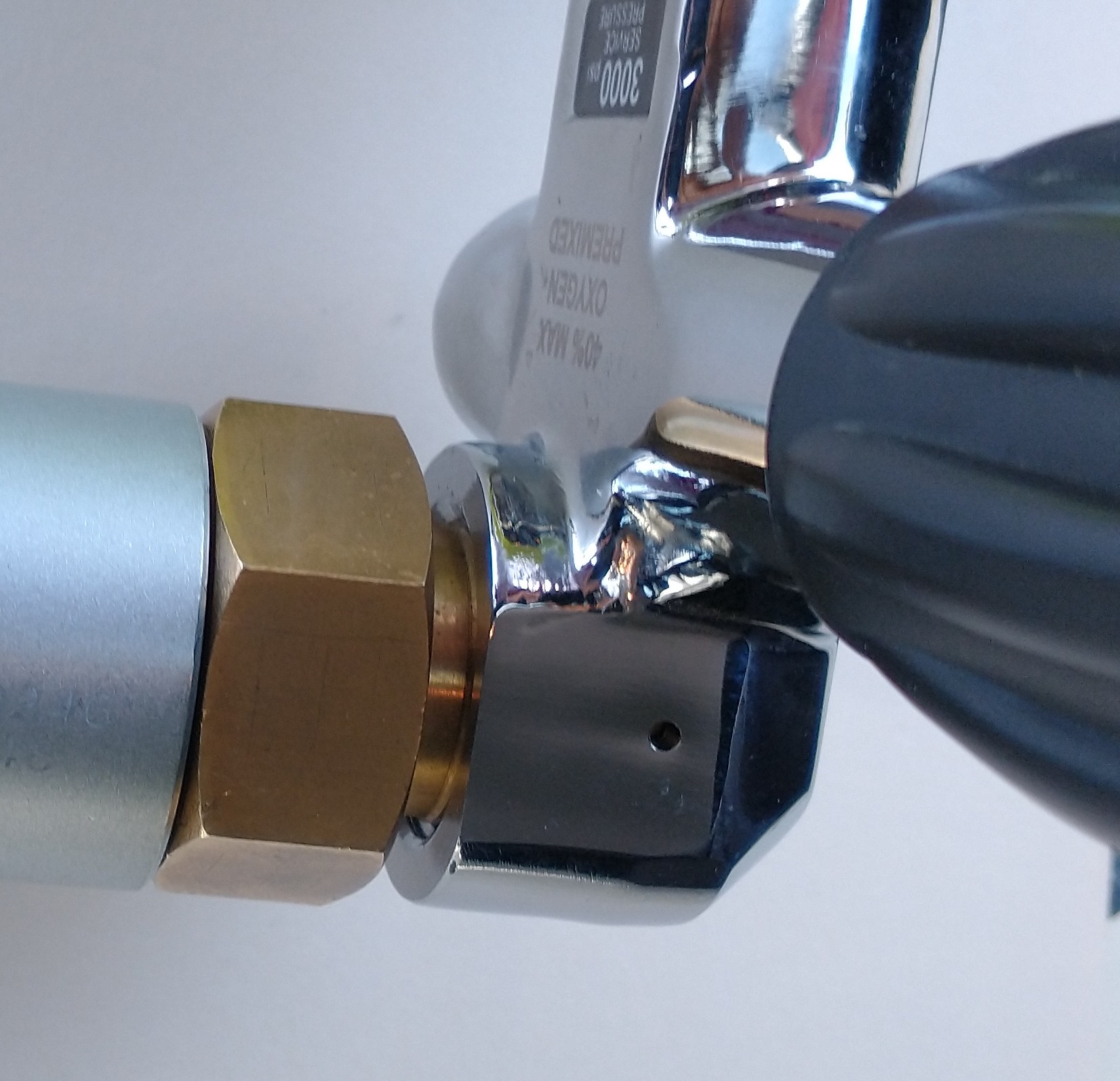

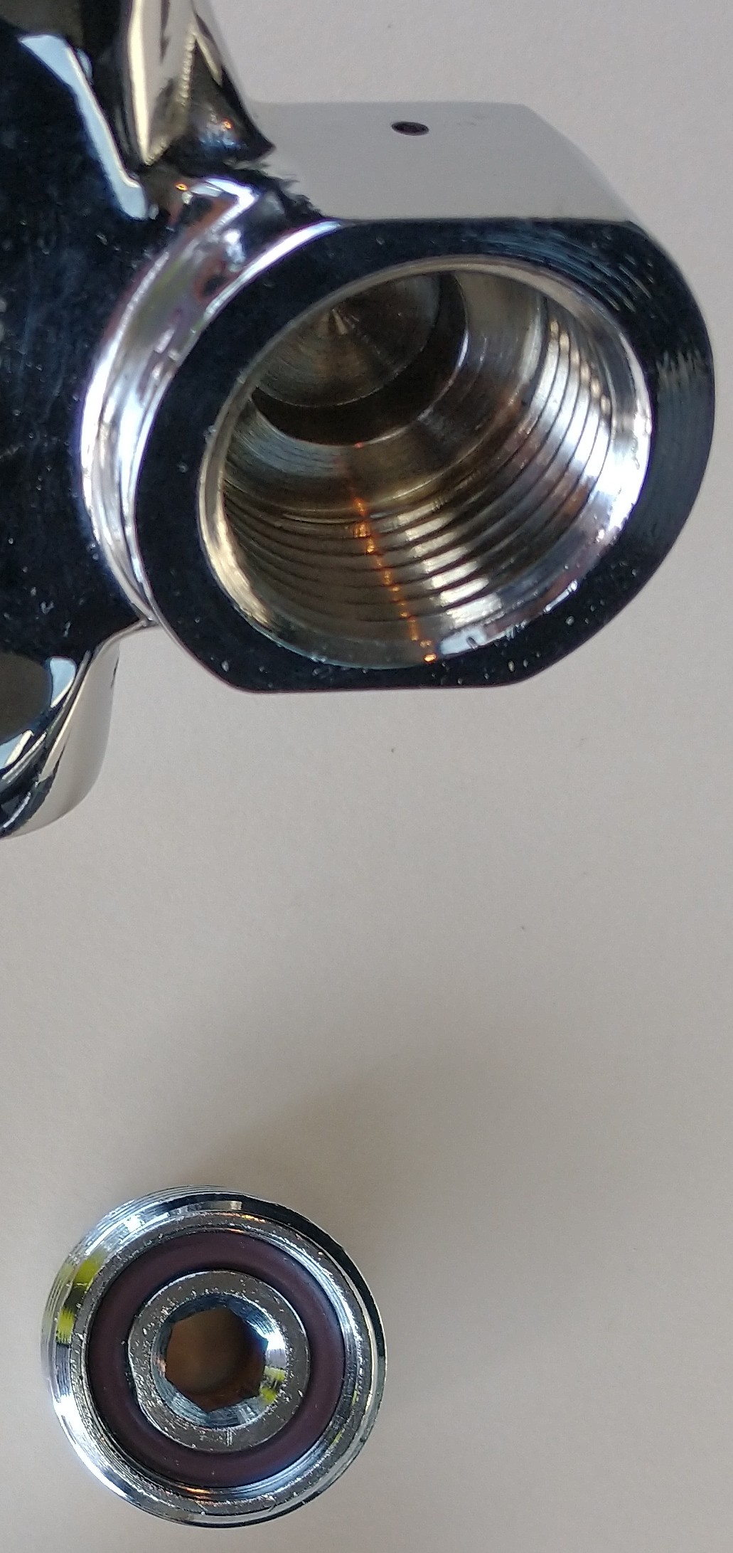

ALL YOU HAVE TO DO...........
Take an allen wrench. Remove the yoke insert. Thread the FWB fill adapter directly into the tank threads just like those German Gun Designers intended it to work and move on.... If you have trouble reading these simple instructions, look at the pictures I attached. Your welcome, I saved you all the time and effort buying useless adapters because I actually did it, and have done it for years because I actually have a P44, and some of us here can't seem to understand how easy it is.......

Yes you are mostly correct. 300 bar parts will not mate with 200 bar tanks without monkeying around with ill advised adapters which in my mind are unsafe.. My 200 bar tank was purchased new at a local shop. All shops require current dive cert cards to refill dive tanks UNLESS the Owners Name, The Max fill PSI/BAR and the words NOT FOR SCUBA USE are labelled on the tank. Not all dive shops will fill them when labelled that way even though its in the regs, they can refuse service. Even then, it also needs to comply with the DOT regs for inspections, just like all other tanks.....
The probability of making an error is miniscule when you follow the rules. At the end of the day, the photos are the simplest method to fill the tank, and the process the gun makers planned for....... We need less overthink, and more trigger time......
