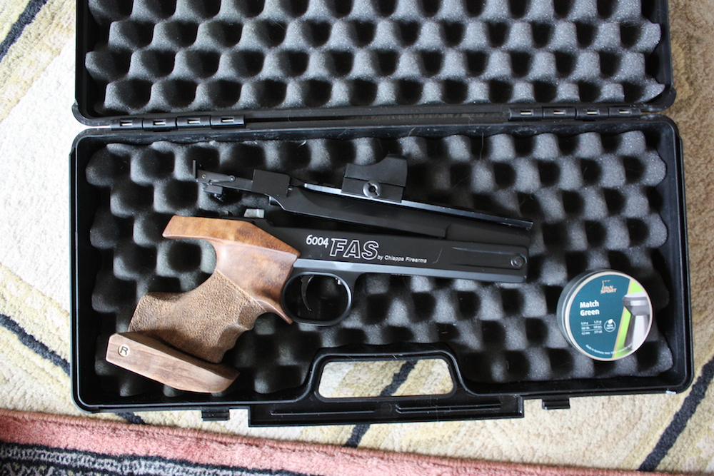

BTW I like the way the gun fits in the hand. I have RINK grip that I only slightly filed down the ridges for the fingers since they cut into my hand. I also soot a IZH 46M which is nice and all that BUT (and remember the word "but" negates all that came before) the simply 6004 feels good. I have a DOCTER sight on top of the base that's sold by the guy in NH. It works fine and is quite robust contrary to those who mentioned the possible strength or lack thereof of the device as attached. There is no issue. It works!
