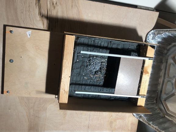

I built a pellet trap for 10M AP in the garage. Consists of a hanging plywood backstop, with an attached metal box containing duct seal putty. As mentioned the duct seal traps most of the lead and deadens noise.
With the first version I hung targets from large paper clips and a clip with a weight on the bottom. Gehmann traps have a better design, with a slotted frame to holt targets that makes changing them faster and easier. Nosing around Home Depot I found inexpensive aluminum material for screen frames had a usable slot for this application. I cut some up and expoxied a press board in the bottom to act as a stop for the target and help make the frame rigid.
Also fastened a heavy foil turkey pan to collect debris.
It works fine now I've got work to do....
- pelltrap small.JPG (42.69 KiB) Viewed 3410 times
