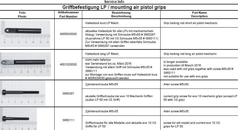

Post by pbrejsa »
to Scott
Yes, the original handles are interchangeable. Newer handles and older guns may be a problem with the clamping rod and the length of the allen screw.
pbrejsa
Posts: 138
Location: czech republic
Re: Steyr LP50 and LP10 Grips
Post by pbrejsa »
see picture
