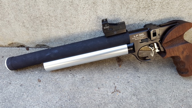

My LP50 is very quiet, target impact is much louder.
