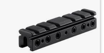

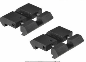

By "merit" I meant things like how well designed the rail attachment system is, is the machining quality good, etc. I don't care where it's made, but ebay has some horror shows that happen to be made in China. I have gotten good value on Chinese made photo attachment accessories, it's a matter of finding the well made version of a decent design.ProdigalSon wrote: ↑Wed Feb 20, 2019 1:03 am Do I use them? No. I prefer iron sights, so no need. With that said, it's a block of metal with grooves in it. There's not a lot of "merit" to be discussed (although I'm unsure how the elevation adjustment works on the one), as long as the rail is milled within the specifications for the particular rail size. Most adapters are going to be made more or less the same way. If you're concerned that it's an import, though, you could try a DIP rail (https://www.diproductsinc.com/Detail.as ... 5&CAT=3600 or https://www.diproductsinc.com/Detail.as ... 9&CAT=3599). They don't make them specifically for KK500, but one of these should fit. You'd need to use set screws for those, however, which could mar your beautiful rifle's action.
Here are some examples.
The Walther barreled action will be put in a custom stock, not sure what the final weight will be. Periodically, the scope will be moved over to a 6mmBR rifle, until I can justify another scope, which sets some additional constraints.ProdigalSon wrote: ↑Wed Feb 20, 2019 1:03 am Recall that your KK500 is around 6 kg. Assuming you're using the normal ammo for the gun (i.e. standard velocity lead 40gr), the recoil velocity is a bone-crushing 0.13 m/s and the recoil energy a mind-numbing 0.05 J. Iron-sight shooters just clamp the sights right onto the 11mm rail, and some even remove them when they're done for storage. It doesn't take much to hold on to that rail under those recoil conditions, so just about anything will work well as long as it fits and the metal isn't so weak that a snug fit damages the threads (which is unlikely unless they're using a 1000 series aluminum or you overtorque) - it's not a situation where rugged, heavy-duty mounts like you'd see in PRS are really needed.
I won't switch often, so I am open to a system that isn't QR.
If I go the non-QR route, maybe I should just go with rings?
