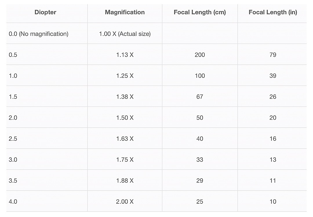

Hello- unfortunately, I have worn glasses all of my life. Diopter means something to me because of this. It may not mean something to others, though.
Here is how I understand it: a diopter is used to identify the light bending capacity of a particular lens. A higher diopter means there is a higher light bending capacity, and thus a greater magnification.
Kind regards,

Re: Shooting glasses question
That's pretty much right, with the table referring to positive diopter strengths, but I am still confused by your second use of the word diopter in the post I quoted.m1963 wrote:Hello- unfortunately, I have worn glasses all of my life. Diopter means something to me because of this. It may not mean something to others, though.
Kind regards,
Many people will have negative diopter prescriptions for distance (normal) use.
