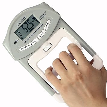

This s a tough one for coaches, because unless you can see a shooter's finger tips turning white, it's hard to tell if a shooting "over gripping". With the light recoil & trigger pull of an air pistol, you do not want to grip too hard. It's not only tiring, but it interferes with fine control of your trigger finger.
I recently purchased a grip force gauge from Amazon: https://www.amazon.com/Digital-Dynamome ... B00A8K4L84
We tested a dozen or so shooters. We had them shoot air pistol for a bit, and then try to duplicate the grip force on the meter. I think the average for the better shooters was around 2 1/2 pounds. One shooter was over 10 pounds, and when I got him to lighten up, his groups were nearly cut in half.
This particular device has a couple issues: it won't "latch" the peak force below about 5 pounds, and it doesn't feel much like a pistol grip. I'm going to work with Andrew Berryhill to make up some 3D printed adapters to help with that issue. One thing that is helpful is that you can adjust the size (spacing) of the gripping surfaces over a pretty wide range.
As far as your fingers & thumb are concerned, you don't want to apply pressure on the sides of the grip. Any variation in that pressure will move the pistol off axis. The most consistent pressure you can apply is ZERO. Relaxing your thumb, finger tips & pinky is a good start, but if you can comfortably get them a little OFF the grip, that's even better.
