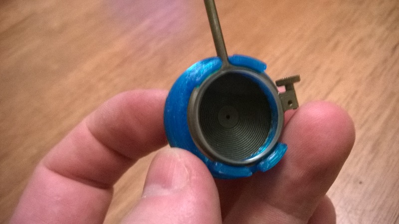

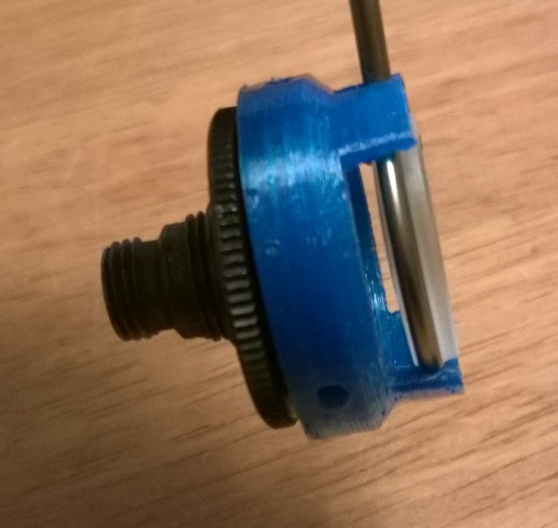

I read the new ISSF rules. Using single correcting lens mounted on the rear sight of a rifle is allowed.
So I started drawing mounting attachments so I could mount the lens and it´s holder (Knobloch) to my rifles.
Plan is to make 3D models of the mounting rings and let my friend 3D print them.
Correction I use is approx. +3 (Don´t remember exact values)
Does it matter, how far from aperture the lens is mounted?

I would place the lens 40-70 mm from the iris orifice. The eye should then be 15-20mm from the other side of the lens.

Thanks, I have seen that Anschutz (or something similar) being used here. I have something similar to that in mind, if the 3D print doesn´t work.
