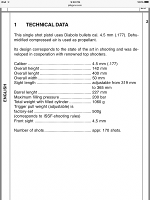

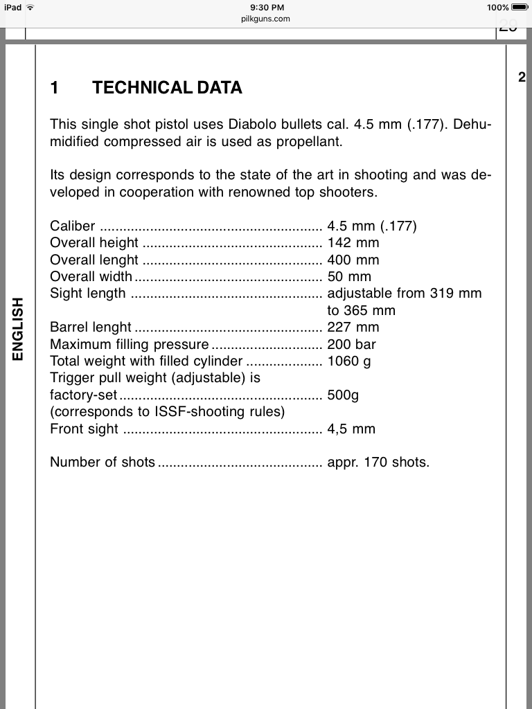

Anyone knows how many shots a compact (short) LP10 cylinder can give?

I tested my LP10 on several occassion sand found I got 180 on the long cylinder and about 120 with the short. I am sure that the manual mentioned the same figures.

Re: LP 10 compact (short) cylinder
Page 30 of the owners manual.....they were being conservative as I achieved 180 shots to the bottom of the green.

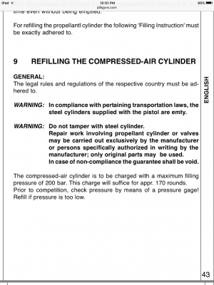

Page 43 of the LP10 manual.
Here is the owners manual in case anyone wishes to see what a steyr publish regarding their own products
Thanks Silvershooter. It makes no sense to publish one figure in the owners manual and another online unless the website figures have been published conservatively for reasons unknown to us.
As I said earlier, on several occasions I clamped my LP10 to a bench and fired 180 shots without any POI change. I stopped where the green zone meets the yellow. The pistol was chronographed at 530 ft/sec.
I am sure other owners have run similar tests and would be curious to hear their findings.
