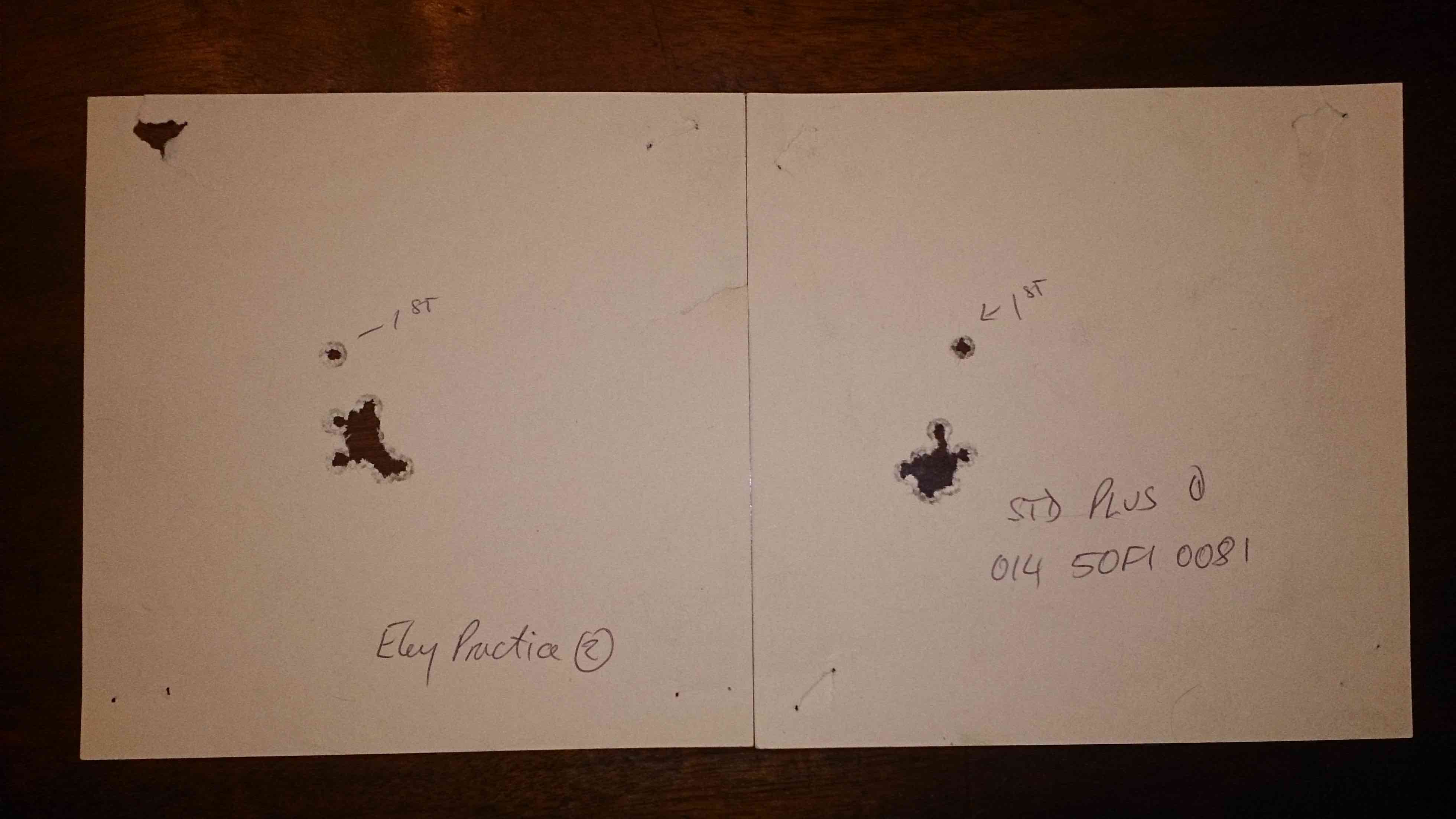

Hey Morten, great link - the pictures give me flashbacks.
Although not an expert in these matters - I recently spent some quality time with a Ransom Rest and a bunch of ammo - including 4-5 lots of Tenex Pistol, Practice, Rifle, SK Standard Plus, RWS and a few odds and sods run separately through Pardini SPs. I had expected Tenex Pistol (the most expensive ammo we had) to shoot the pants off the rest (so to speak). However, not the case. My earned advice would be to test as many types you can find (by lot number) and when you find a great shooting lot - buy it.
A variable we did not test (or plan to) is the consistency of a lot over several boxes. A couple of lots of SK Standard Plus out performed the Tenex Pistol (which runs at over three times the price) and one thought was that maybe the cheaper ammo had a higher frequency of 'outliers' within the lot, ie a 1-in-100 outlier or a 1-in-200 so that maybe the value of the primo ammo (and the (wallet-emptying) mental health that goes with it) is the consistency over 100s of rounds that tests and comparisons of sample sizes of 10-20 rounds do not uncover. To do that we would have to acquire $200 worth Tenex (maybe using two lots of 200 rounds each), similar quantities of other ammo and design a robust statistical test employing excellent method (maybe double blind requiring division of duty). Not for the faint hearted.
As a side note - we (independently) noticed that the first shot of a string (from our SPs) appeared to generate outliers (mostly high). I am aware of the 'more boys get born during a full moon' statements but we all mentioned that 'something was going on with the first shot'. I realise that we need a robust test to determine if the observations have statistical merit but it encouraged us to 'double down' on our shot-preparation method for consistency and one factor I tried to eliminate was 'chambering velocity' by inserting the magazine of the next string when the last shot of the current string was chambered so that the round would be 'auto-loaded' as opposed to a manual release of the slide (which is an obvious difference in the way we were shooting strings). It seemed to smooth out the results but we need a robust test to determine if the conclusions from our observations have significance.
Anyone else noticed this? - see the attached photo.
thanks
~zip
thanks
~zip

The issue of minute differences in barrel lock up and seating was always one of the arguments of why theoretically revolvers were more accurate then semi-autos. Same for bolt action rifles over semi-auto rifles.
Does the Pardini use a buffer system at all? That I can see would definitely give a different slide velocity depending on if the gun was hand cycled or not. Recoil spring weight and wear could also be a factor. I'd replace the recoil spring and buffer if so equipped and see what happens.
If the spring was very heavy I can see it causing issues as well. If the recoil of the cartridge normally doesn't fully compress the spring, the energy the spring supplies to action is specific to the amount of energy each cartridge supplied it with under recoil. Manually working the action is highly unlikely to get it tot he same spot as firing a cartridge is, so you'll have a different amount of energy seating the cartridge. I can't imagine an Olympic style pistol being that heavily sprung though.
-Jenrick
-Jenrick
