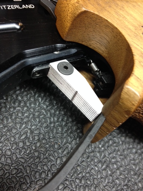

I am evaluating another type of trigger shoe, I have been using a stick type, cylindrical and smooth. This one is flat and checkered, feels very good so far.

I am using one of these triggers, with an added small notch to assist in weighing the trigger, from Ronny Nilsson at Interprodukter in Sweden.
It was very strange. I fitted it and from the first shot it felt so natural that I forgot about it.

Absolutely nothing against it, apart from the difficulty with the trigger weight..
As I said, I feel it needs a small notch on the left hand edge to sit the trigger weight in, but that just takes a few strokes with a small file.
A bad photo of rough workmanship, but it works.

....I have tried it on the pistol of a friend. And I have to say it feels great. It's natural finger inclination and allows just one position for the finger. No different hights , no different depths!

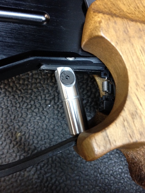

Haireacane, After experimenting with the flat trigger for a few weeks, I found that my horizontal dispersion had increased significantly. I went back to the stick trigger and like flipping a switch, targets tightened back up. I am convinced, the stick trigger induces the least detrimental input to the perfect release.

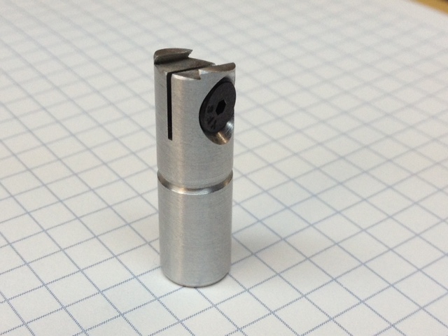

Gwhite, I was making the stick triggers for the LP-10, upon request, I made a few for the 162EI. The Morini was more time consuming to made due the 6mm dovetail and clamping screw slot.

Thanks! I'll have to get a small dovetail cutter & fire up my shop.
I can start with 3/8" rod and turn it down a bit below the dovetail section. What size screw did you use?

The screw is a 4-40x1/4 FHCS. I used a .022 slitting saw to cut the clamp relief slot, .400 deep. Dovetail is a 6mm x 60 degree, cut at a 15 degree angle .038 deep. I could not find a 6mm dovetail cutter, so I made one out of .250 dia. O-1. Finish dia. is .345, much larger creates instillation issues.
Hope this helps.

Thanks for all the details. I'll have to see about getting a dovetail cutter that small. The rest should be doable with materials & tools on hand.
