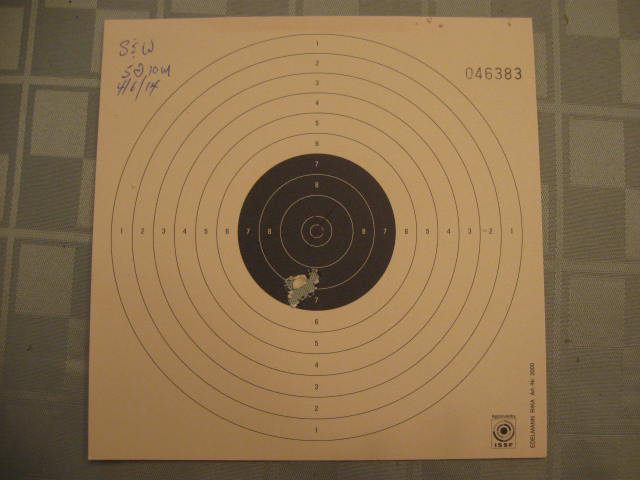

Is the normal aim through the site to low 6 o'clock? Is it normal to be aiming low around 3 ring at 6 o'clock on the target? Just wondering if this is too low? Thanks Ron

Most literature I have come across says most folks use about the 5 ring, for me I end up closer to the 4 ring on top of my front sight . The other consideration is that it can be the same spacing down below the 7 ring (this is the bottom of black bull) as the amount of white space between one side of your rear sight notch and the front sight post, this is often about the 5 ring.

darticus wrote:Is the normal aim through the site to low 6 o'clock? Is it normal to be aiming low around 3 ring at 6 o'clock on the target? Just wondering if this is too low? Thanks Ron
I aim about half way from the bottom of the black to the bottom of the target, so you are not far from that. If you are shooting the groups posted, I would say it works for you. No need to change to what someone else says......

Thanks all just thought maybe I should move to about 5 ring and reset my sight. Ron
