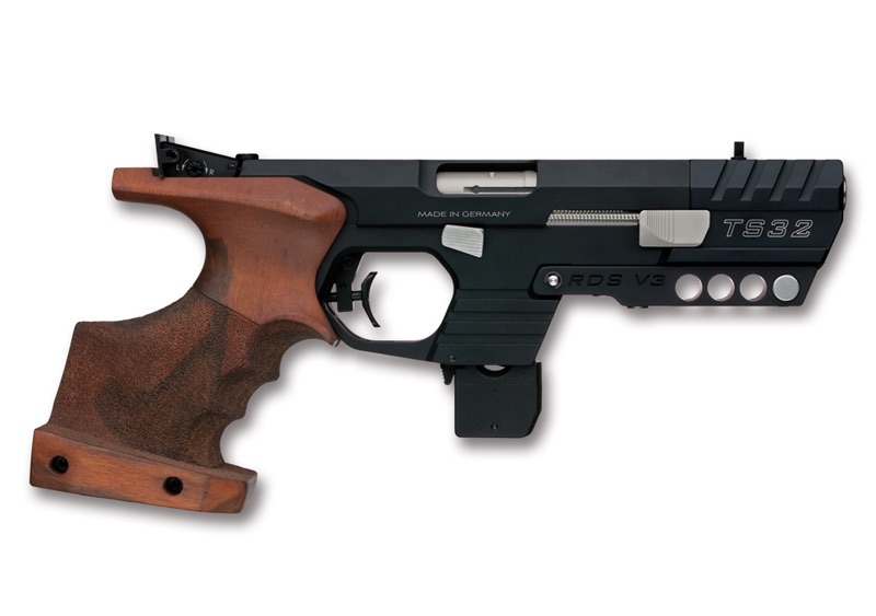

Re: Does anyone have experience with the 2015 Tesro .22 and
+1Nice looking piece of hardware
Hello,
The 2015 models are the -3 and the -3 Pro version.
The -3 has been available from 2007.
The -3 Pro has been available from 2012(?).
The Pro has a rear sight with an adjustable width and standard a mounted RDS(recoil damping system) with removable weights (option for the -3 model, earlier versions of the RGS had fixed weights).
I own, and have experience, with the -3 model with RDS. The weights in my RDS system were not glued and were therefor removable (with the Pro version they can be clamped with a set screw).
See earlier comments in: http://www.targettalk.org/viewtopic.php ... ilit=tesro
The rear sight parts move simultaneously.
Maybe the trigger mechanism looks familiar but the mechanism has been designed clever and adjusting it is very easy (compared to an SP20).
Tesro has a manual (for the -1 version but basicly current) in their download section). http://www.tesro.de/?MSID=43&
Kind regards,
Frits
PS
Tesro are not indistructable and malfunction free but I am still a happy Tesro shooter.
