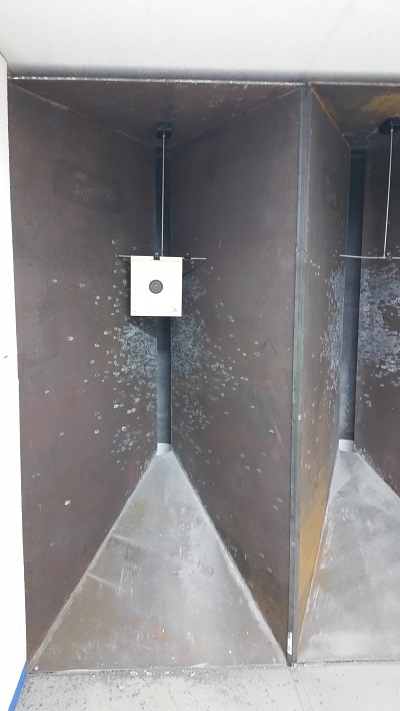

I built a range from a 53' high box shipping container. It works quiet well, and no taxes added to the property. Mine is fully insulated with plywood walls and ceiling. The backstop is made from AR500 steel. This has stopped everything I have thrown at it. (Hand gun only). With the addition of infrared heat it is my year round sanctuary. Out side the shooting sounds like someone is hitting a anvil with a hammer, not very loud at all. Most of the sound is exiting through the ventilation. My nearest neighbor is 75 yards away with trees in between, and he has never asked me what the late night hammering was about. There is sufficient info out there about building a range of this type. Several companies use them as portable training for law enforcement. Good luck.

If you search it has happened many times. Installing adequate ventilation proved to be the most challenging part or the project.
- range4.jpg (37.36 KiB) Viewed 14049 times
- Snail shell traps.
- range3.jpg (25.3 KiB) Viewed 14049 times
- AC works great
- range2.jpg (38.14 KiB) Viewed 14049 times
- range1.jpg (44.39 KiB) Viewed 14049 times
