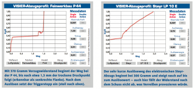

I think this graphis can resume everything, and in the end, what counts is the ability to dial the trigger so you can get the "curve" that you want!
My LP400 and my sold Benelli kite had a 1st stage spring that would sum to the second stage spring. This means that the 1st spring will be adding weight to the trigger after the first stage, because of the trigger travel. So if I could measure the weight of the second spring in separate the total wieght would always be more. Another thing I've noticed is, even without springs, the sear adds some weight to the trigger. I Just try to feel it (and measure it) like in the graphics...
There are other limitations, like if I set a small first stage travel, the initial weight will always be higher... I can say the sear adjustment on my LP400 is so small, but I never had accidental discharge (worst case scenario, it doesn't lock)!
