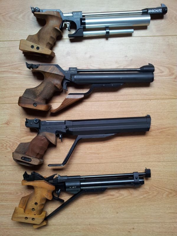

Glamor shot!
Glamor shot!
My sweetheart LP-@ is only 1041 grams with the weight bar and one weight.

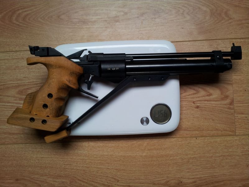

IZH-46M has a little of the stock grip removed, but is otherwise stock at 1156 grams.

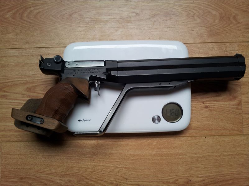

FWB100 is a hefty 1160, but includes some instamorph I added to the grip.

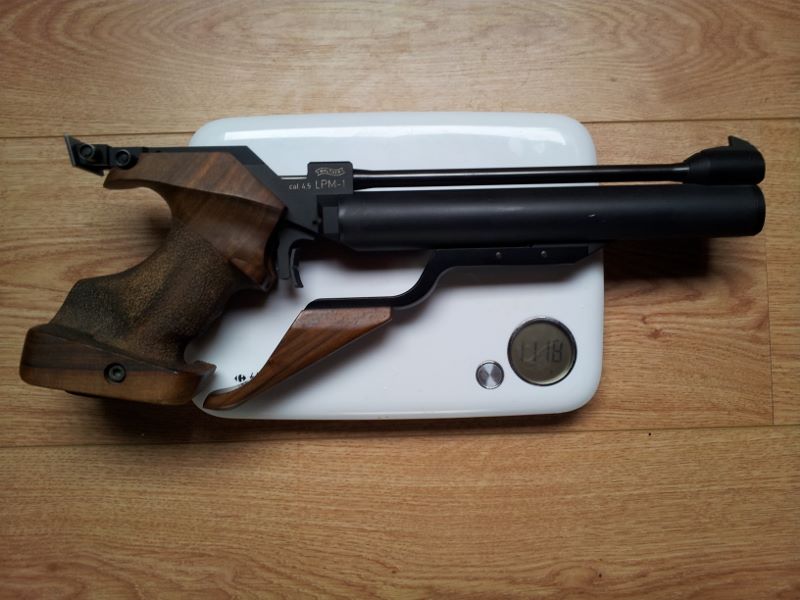

LPM-1 is 1118 grams.  No extra weight.  Stock.

Very nice collection. I know how the IZH 46m balances, but wonder how the others balance in comparison? Are they all muzzle heavy?
David W. Johnson
Posts: 238
Joined: Fri Aug 11, 2006 9:40 am
Re: Weight comparison - LPM, FWB100, IZH46M, LP-@
Post by David W. Johnson »
The IZH and FWB are muzzle heavy. I moved away from the IZH because the grip does not have enough angle for me to lock out my wrist. The FWB is adjustable and helped. The LPM is still a bit muzzle heavy, but not as bad. The LP-@ is not at all.
David

The grip angle on the FWB and LPM1 looks more pronounced than the other two in the first picture.Is the front end weight affected by this grip and the "locked wrist"position?Both of the before mentioned pistols would suit me better than the LP@ or 46M.I have a difficult time shooting the military grip angle pistols;can't seem to keep the side wiggle corralled without locking my wrist.Anxious to meet Fannie.
Bill
David W. Johnson
Posts: 238
I bought Fannie primarily for the steeper angle on the grip. It is adjustable. It is at the greatest angle allowed by the mechanism in this picture. The IZH angle is too close to 90 degrees for me. I had the same problem you are describing. The LPM is also good with the angle. I love my Annie (Anschutz LP-@) but wish I could get just a bit more angle out of the handle. When I got it perfect, it threw my sights off. I finally realized that I had adjusted the grip until the wood was pressing up on the bottom of the rear sight and had to adjust it back. If I could find another grip, I would be willing to remove wood to make it work out, but I hate modifying a perfectly good grip.
