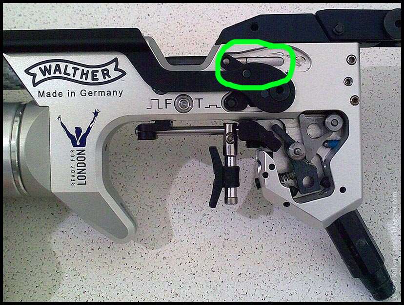

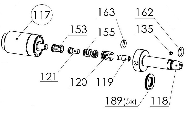

How do I know if the LP400 absorber is operating?
I have attached a picture (not my pistol) of the slot where I can see the absorber but it does not change position when I fire it with a pallet in the chamber.
When the absorber moves towards the rear after firing does it stay there? Or will it rebound back and connect back onto the loading plunger (sorry for all the poor terminology).
I just checked and noticed that I have two different exploded diagrams. An earlier one that shows all the individual parts of the absorber valve and one that shows the absorber as a complete assembly. Based on what it looked like when I dissembled it I have the later one.
I tried the adjustment screw #197 1 turn in and 2 turns out from factory with still no absorber movement.
How do I test that the valve is letting the air through to release the absorber?
Can the valve on the later ones be disassembled or adjusted?
When I reassembled the absorber I left the magnetic piston is the "fired" position. When I cocked the pistol you can hear a two distinctive clicks, one of the sear and one of the magnet jumping back onto the loading plunger. If this is the standard operation for the magnetic to stay back and get picked up when cocked then I do not think I have ever heard this second click before, or it was a long time ago.
Also be warned if you attempt to pull that later model absorbers out there are two plastic balls in the side of the absorber piston (#183 on the exploded view). These are under spring pressure and they WILL go flying when the piston is removed. Do this in a plastic bag and save the time on you hands and knees looking for them on the floor.
Re: LP400 Absorber
I have the early Absorber so I refer to these numbers.
As you cock the pistol the Slide Tappet 118 is moved aft, compressing the spring
until it is close to the Absorber Weight 117.
When close the magnets attract and connect. This is one of the clicks you hear, the
other is the trigger setting.
When the breech is closed the Absorber weight moves forward with the Tappet, this is the
cocked position as shown in your photo.
When fired the air pulse travels thru the Adjusting screw 119 and impinges on the Trigger 120
to push apart the magnetic faces, releasing the absorber weight and the springs push it aft.
To adjust Screw 119, cock the Absorber then slowly turn 119 in until the magnetic faces release.
Then turn the screw out 1/2 to 1 turn (adjust for feel).
To achieve the required backpressure to fire you need to fire a pellet in the chamber. BE CAREFUL use
all normal safety as you live fire test the pistol.
When fired the Absorber weight 117 is in the rear position and the spring is visible.As you cock the pistol the Slide Tappet 118 is moved aft, compressing the spring

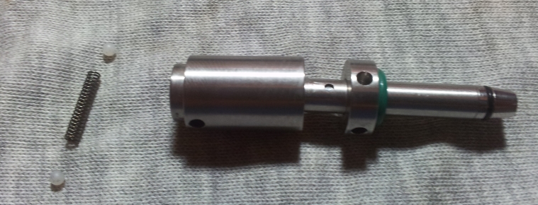

Re: LP400 Absorber
Thanks David
based on the information that you have supplied my absorber is not working. I doubt that it has every work constantly. Maybe 1 in 100 shoots.
The attached picture is how my model absorber is shown in the exploded diagram. When disassembled my Slide Tappet looks as if it has been pressed together. Not sure if it is serviceable. Part 183 are the little plastic balls that go flying if you are not careful.
I will pull it a part again at a later date and add some photos.
Anyone else have any suggestions?

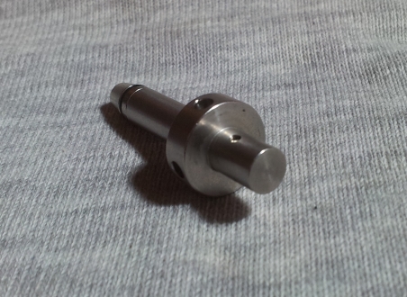

Re: LP400 Absorber
Shot a bit of a practice match tonight. Out of 60 shots I did not feel the absorber activate and visually check nearly every shot and it was still in the forward position connected to the Tappet. After 30 shots I unscrewed the bleed screw in the frame at the back of the absorber channel to see if it made a difference. Only backed it out two turns and no difference.
Here are some photos of the inside of the newer absorber.
From what I can see the Tappet can't be disassembled.

Re: LP400 Absorber
Love to get it apart or even see the CAD model to see how it works.
I can't see how the air can act directly on the magnet. There are two closed holes at which can be see in the picture that the magnet sits over. For air to get this far down the Tappet it has to pass through the larger mid section where the cocking leaver mounts. There are two holes which are 90 degrees apart from the cocking lever holes and they pass through the center so any air would be vented through these. You can also see a very heavy spring that runs through the middle of the Tappet.
My theory is that air enters the front of the tappet and acts on a piston that is held closed by the heavy spring above. This piston actions on another magnet in the rear of that Tappet (you can feel the magnet in there with the larger magnet removed). This disturbs the magnetic forces between the Tappet and the magnetic weight and the weights shoots to the rear. The two little spring loaded plastic balls are used as a damper system. Just a theory.
