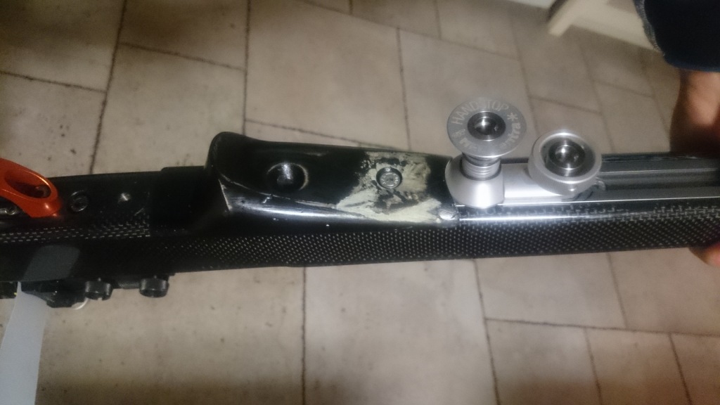

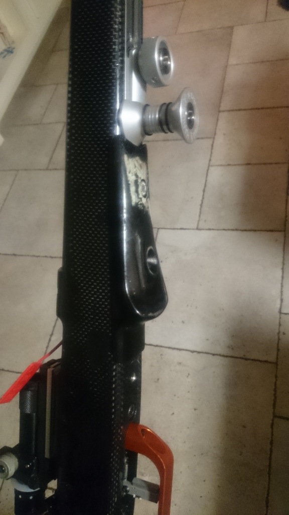

I had the same problem with my 1813 stock.
I ended up making a wedge shaped to my hand. I used epoxy filler and also some polyester body filler.
I first taped up the area on the stock that I was going to mould the wedge on to so it would not permanently stick to the stock.
I moulded the basic shape using epoxy putty then finished off with body filler. I had a plastic bag over my glove and also taped up the hand stop and anything that might get in contact with the filler.
Then removed and sanded down the filler so it looked good. A few coats of paint so it didn't look too bad but you can also buy black fillers that might not need painting.
See the photos of the wedge I have on my current stock. It's a bit worn now and I chose the wrong paint but you can see the idea. As you can see this wedge is bolted to the rail but you can just use double sided tape to hold in place.
Henry
