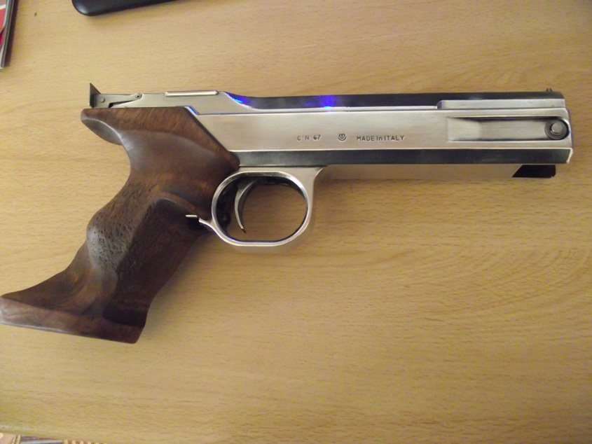

A very interesting pistol indeed. The pistol has the resemblance of a FAS 606.
Is the cocking effort easier than a FWB 103, and what is the value of the CM800E?
Tycho
Posts: 1049
Location: Switzerland
Post by Tycho »
No, the 103 is far easier to cock than the 800E. And the 606 is, IMO, nicer to shoot, even if it's as slow as molasses. All in all, I wouldn't shoot the 800E, but I find it a fascinating piece of engineering. Value is whatever gets paid :-)

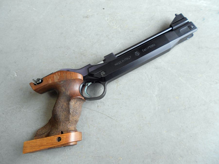

I have 2 Air Match 600 and 2 Fas (1 AP604 and 1 AP606).
Due to their mecanical conception, the Air Match and the AP606 are very fragil. I think that the Pistol builders had reached the limites of complexity.
They are very nice but the metallic parts get damaged if you use them intensively. And, no hope to find spare parts for them, AirMatch disapears and Fas doesn't have any parts for the 606 (I asked them).
Nevertheless, the AP604 is a very lightweight and good pistol, accurate and with a great stability, easy and cheap to maintain and to repair by yourself, and still in production by FAS DOMINO.

Ben, do you have a how to guide on AP604 trigger adjustment?
I have AP604 too. It´s grip is closer fit to my hand than the Morini that came with fwb 65. But trigger on this AP604 is horrible..
My 65 now has new seals and spring. I tested it yesterday. If the grip was better fit and trigger shoe closer...

A solution to have a better FAS604's trigger is to change the trigger spring (part number 274) or to ''releive'' it.
I measured the trigger's weight before to adjust this spring : 600 grammes
After : 510 grammes which is better.
I know that it is very boring to adjust this trigger but when you find the good adjustment, it is a real pleasure!!!
If you turn too much a screw, it doesn't shoot and you have to adjust the other screw... And so on, and so on...
One question : how old is your FAS? What is its serial number?
I know that old ones are more efficient and mechanicaly adjusted than recent ones. Mine is quite old, N° 7223. probably made at the end of the 70's !!! I realised 549/600 with it.

BenHHH, My pistol is SN: 14564.
I did some adjusting and got the trigger better. Still quite heavy, but I adjust that some other time.
