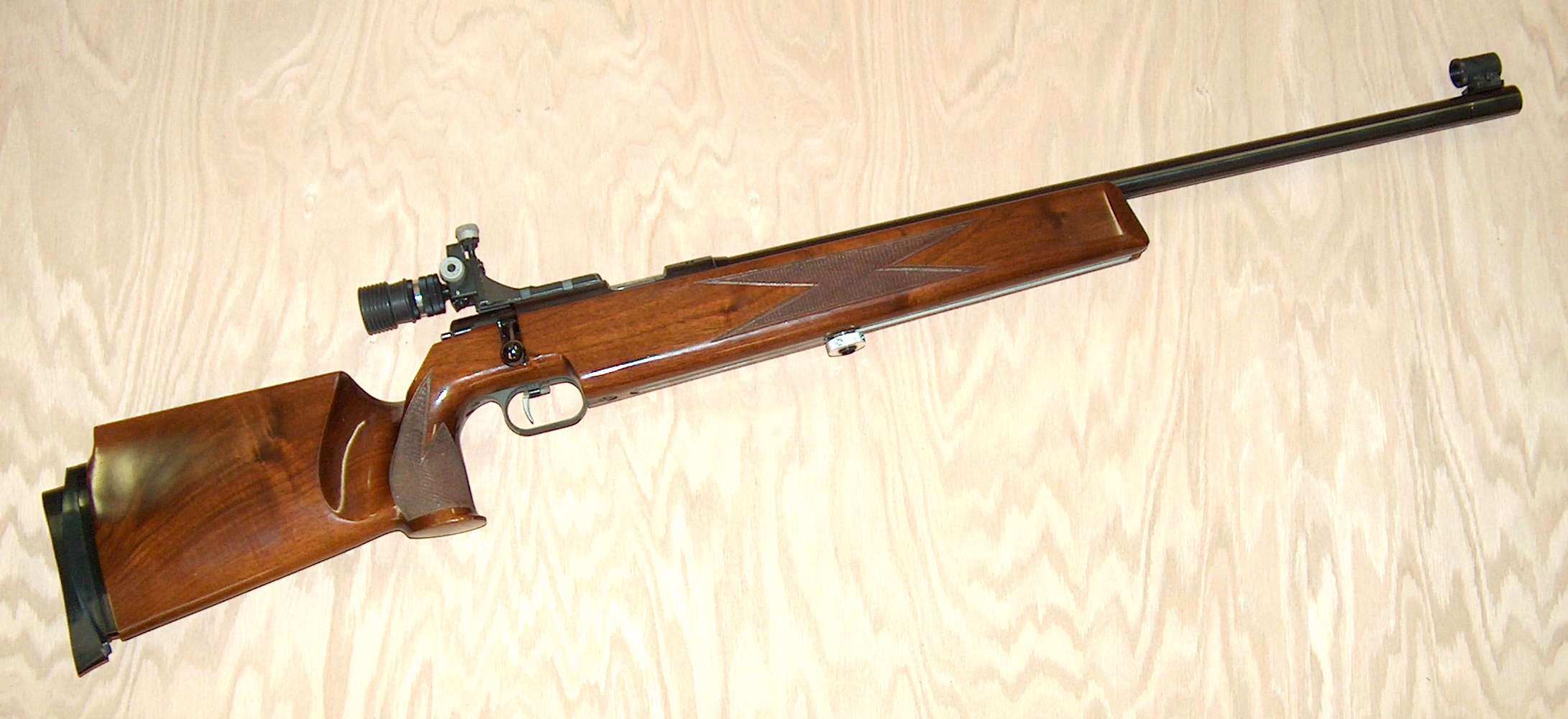

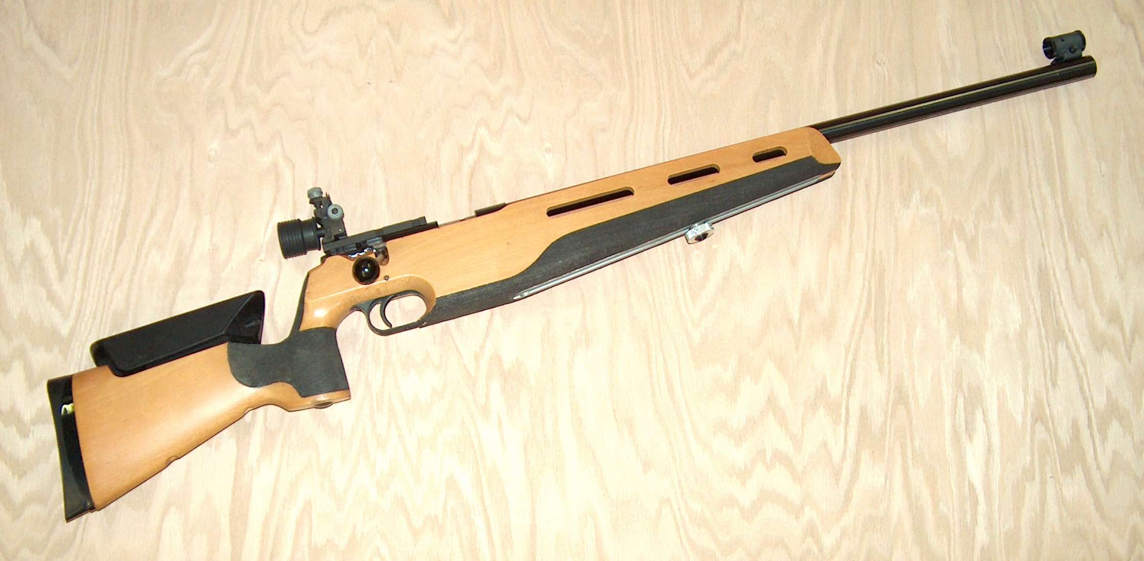

Anchutz model identification
It would be nice to have pictures of the different stocks to identify the models. What exact model is this one. Barrel dated 1969 match 54.
