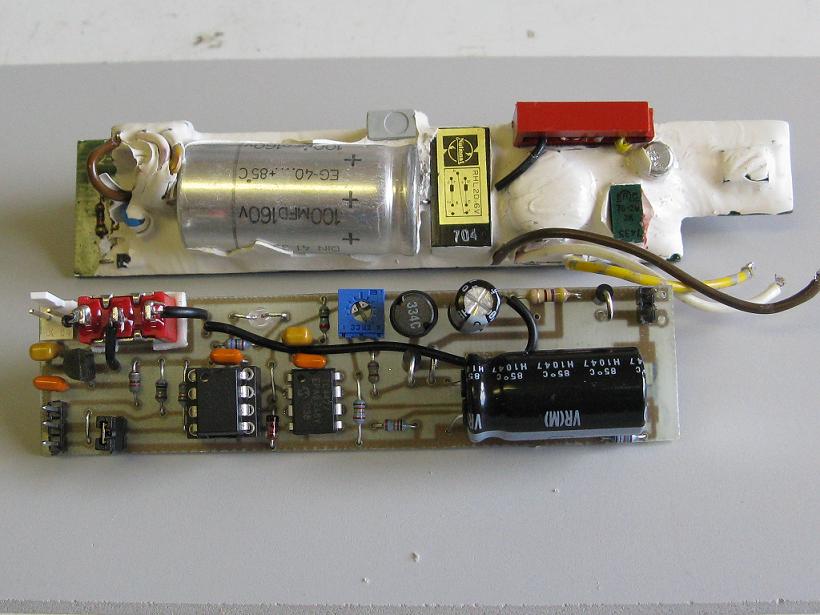

I've attached a photo of my new board below my original factory board.

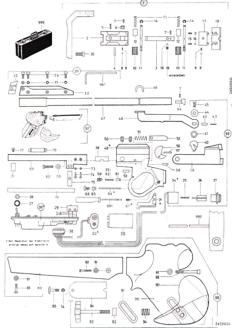

I've attached a factory parts list to which I referred, above.
jbshooter
