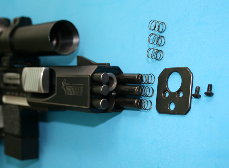

1. The barrel housing contains a special active counterweight compensator. This is a system of six counterweights and springs which reduce the recoil and helps you to recover it. One can chose between steel and tungsten (carbide) counter weights and can play with the number of weights used and their location (Top, middle, bottom).

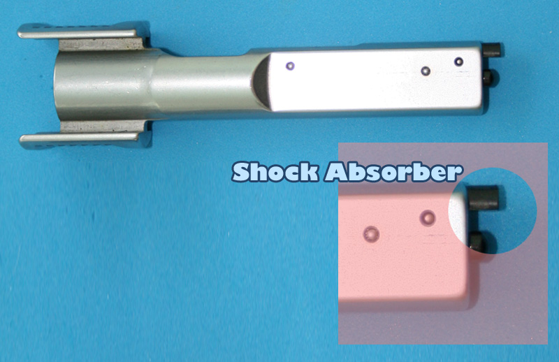

2. The bolt has integrated shock absorber. It is a piston, that absorb the energy when the bolt hits the frame after the shot. As a result you have the effect of the recoil sprig added to this of the shock absorber. This again reduces the recoil and makes the recovery easier, which is key if you have to do multiple shots in a short time.

Pardini SP and HP Active Couther-Weight Compensator
Post by PardiniUSA »
Guys, here are the illustrations for what the Active Couther-Weight Compensator looks like.

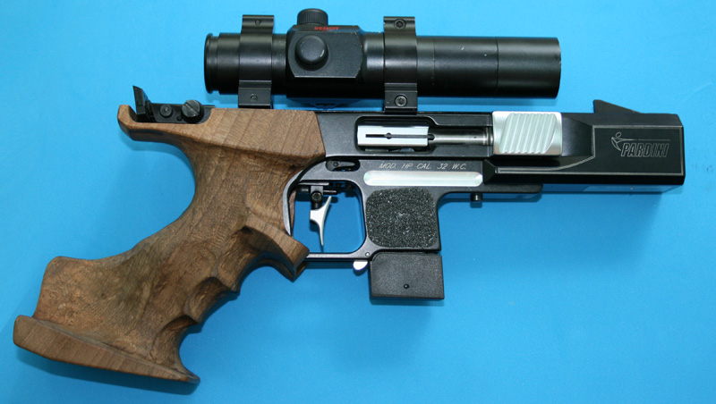

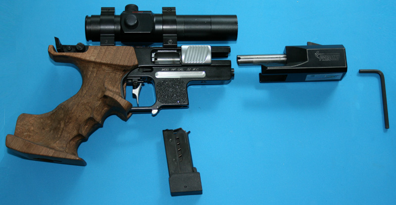

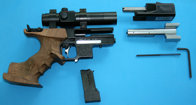

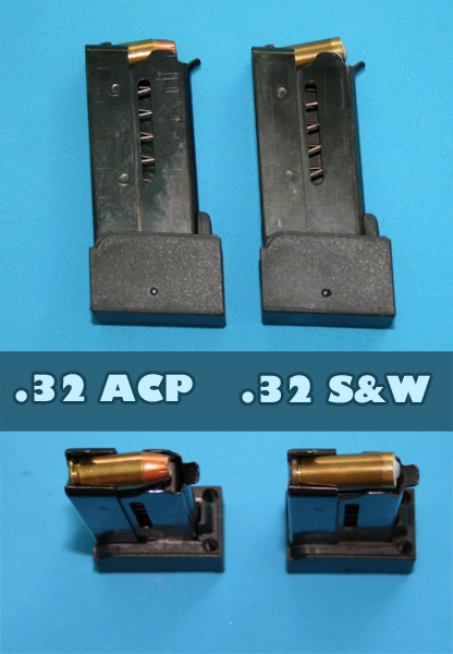

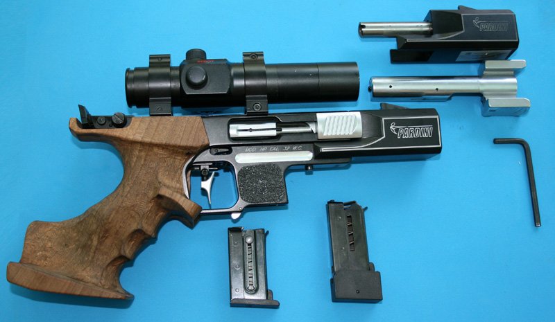

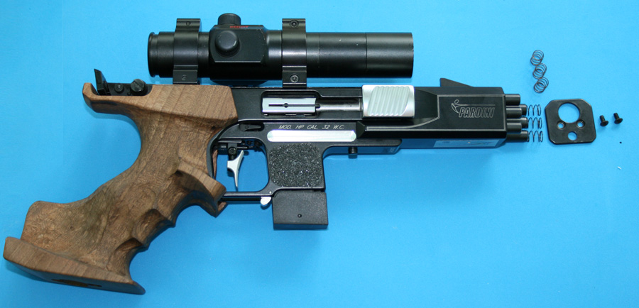

Guys, here are the steps to convert the Pardini HP Caliber 32 ACP to 22LR.
Step 1. Take the .32 caliber magazine out.
Step 2. Make sure the gun is empty.
Step 3. Unscrew the Counter-Weights Ries Locking Screw.
Step 4. Remove the .32 caliber Barrel Assembly.
Step 5. Remove the .32 caliber Bolt and the Recoil Spring with the Guiding Rod. Based on the ammunition you may need to use different spring.
Step 6. Install the .22LR Bolt and the Recoil Spring with the guiding rod.
Step 7. Install the .22LR Barrel.
Step 8. Make sure you re-tight the Counter-Weights Ries Locking Screw.
Step 9. Insert the .22LR Magazine.
The same think can be done to switch 32S&W long (Wad Cuter) to 32ACP and 22LR. Same magazine is used for for both 32 caliber ammunition
You will be able to chamber 32 ACP in a 32 S&W barrel but it is not recommended from safety and accuracy point of view. When converting from 32 to 22 based on the 22 ammunition you may need to replace the recoil spring as well. Other then this it takes seconds to do the conversion. Again the fact that you take a barrel off and on will not change the zero. Of course you will have difference in the zero between 22 and 32, or between 25 and 50 yards and you will have to do the corrections but they will be the same every time.

Same magazine can be used for both 32 calibers - 32ACP and 32 S&W Long (wad Cutter)

PArdini HP cal.32 converted to Pardini SP cal. 22LR

Pardini HP with removed Barrel Assembly, Bolt, Recoil Spring with Guiding Rod
Pardini HP with removed Barrel Assmbly. The scope is attached to the frame so you will know what your corrections are.
Pardini HP 32 ACP with attached scope

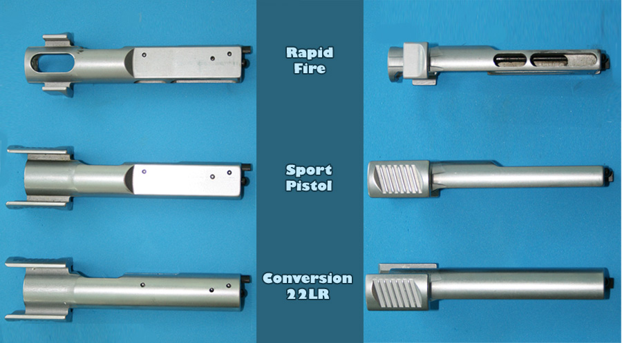

Pardini SP 22LR bolt variations
Here is picture with the three different models of the 22 bolt. The rapid fire is the lightest one with the main goal is to ensure foster cycling and les recoil. The conversion 22 is the heaviest. The conversion model is designed mainly for the US market and the bullseye event. The idea is to use one gun with same trigger and same scope and shoot the 22 and the center fire portion of the match. Since the slow fire is at 50 yard distance the heavy bolt is beneficial for better ballistics in a blow back guns.
The second image shows the position of the shock absorber.

The Shocj Absorber is integrated in the bolt. This makes it easier for monitoring and service.

Hi Richard!
The 32 ACP and the 22LR conversion was initiated by Pardini USA in 2009 and started as a project specifically for the American marked. The goal was to address the needs of the bullseye shooters.
We were demonstrating the gun in Camp Perry in 2010 and this year as well.
Last year John Ennis was shooting the Pardini 32 ACP with 22 conversion. He won the center fire match. This year in Perry Emil Milev used 32 ACP - 22 conversion in his debut at 2700. He was shooting iron sights and placed 4th overall in the center fire match and won the rapid fire portion. I know that we have to do better job for informing the shooters what we have and I hope that with these posts I am doing progress :)
And, yes, we listen to any critics, suggestions, problems and needs of the shooter so that we can address them. Our pistols wouldn't be what they are without the help of all who are shooting them. Help that we appreciate VERY MUCH!
About your second statement - yes, Steyr is dominating the Air Pistol event same as Morini is doing it at the Free pistol and Pardini in Rapid Fire and Sport. But again you will see different guns at the firing line because of the personal preferences. The competition between the brands is what gives us better guns. You can trust me, we work hard to catch up with them and make even better guns :)
