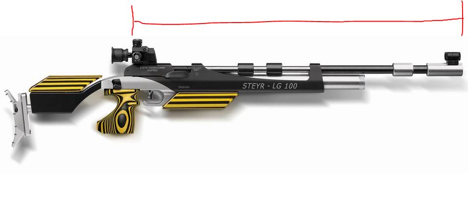

With that 850mm I'm not totally sure where I need to measure from.
I found a good pic of the gun I have and marked out where I think I'm supposed to measure from. Can you tell me if this is correct?
Thanks.

by Rutty » Fri Jul 09, 2010 11:35 am
You've got it talladega, muzzle to rear of the "action".

by jhmartin » Fri Jul 09, 2010 6:23 pm
Talladega .... your drawing seems to look like you've marked the back of the rear sight....
Ruddy is correct, it is to the rear of the "system".
Where the rear sight is does not matter ... if you've got a rulebook handy, look at the drawing in 7.4.2.6

by talladega » Fri Jul 09, 2010 10:50 pm
Oh... yeah I figured that is about where the 'system' ends. I know it isn't to do with the rear sight.
I measured my gun and its about 840mm - 845mm or so. So I guess I can't get an extension tube.
