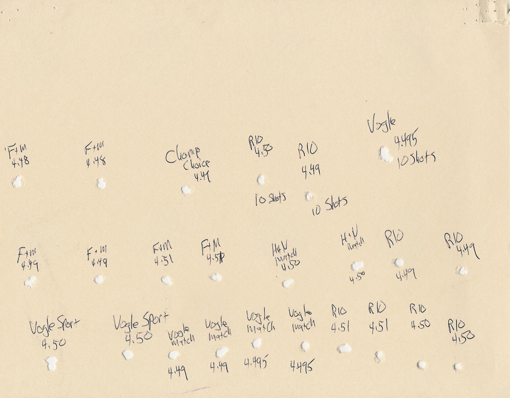

All rifles are individuals and you need to test your rifle to see what pellets it prefers.
But I've tested probably 5 or 6 2002's for kids in our club and If I recall correctly all of them preferred some size of RWS R10 heavy the best.

TWP posted a fairly comprehensive bench test using various pellets on a 2002. We're using R-10 Heavy 4.50 with our 9003 -- scores still aren't high enough for the pellet to matter, but it's nice to know that the pellets are consistent & variations probably aren't because of pellets.
While composing this, I found a copy of TWP's test target. All groups are 5 SHOTS UNLESS NOTED OTHERWISE. Hope it helps.
TWP's Test Target
TWP's Test Target

The 2002 that my daughter uses like 4.50 pellets the best and shoots very well with R10s.
We also got a batch of Scott's Vogel USA pellets a while back (the ones he makes) in 4.50 and they shot as well or better than the R10s. Very, very nice one hole groups
