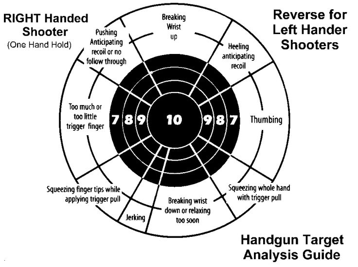

The following seems to be happening to me more often than not lately. After shooting the first 5 shot string in either Timed or Rapid Fire,
I will peek through my spotting scope in order to observe and check my progress. All of the hits are in the X and Ten Rings. After the second
string is fired, two hits just barely made it into the 9 Ring. Both of them are at the far, nine o'clock location. The other three are in the center

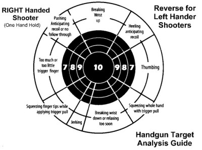

of the bullseye. According to the guide above, "Too much or too little trigger finger" is the cause of those two errant hits. How can this be? I do
believe that this is not a case of inconsistent trigger finger placement. When positioned on the trigger prior to the start of the string, my finger
seems to be staying in the same spot. If this is true, then what is causing those stray impacts? Did the size of my wobble area suddenly increase
during the string? What else might be causing this to happen? Do note that I am right handed. Thank you!

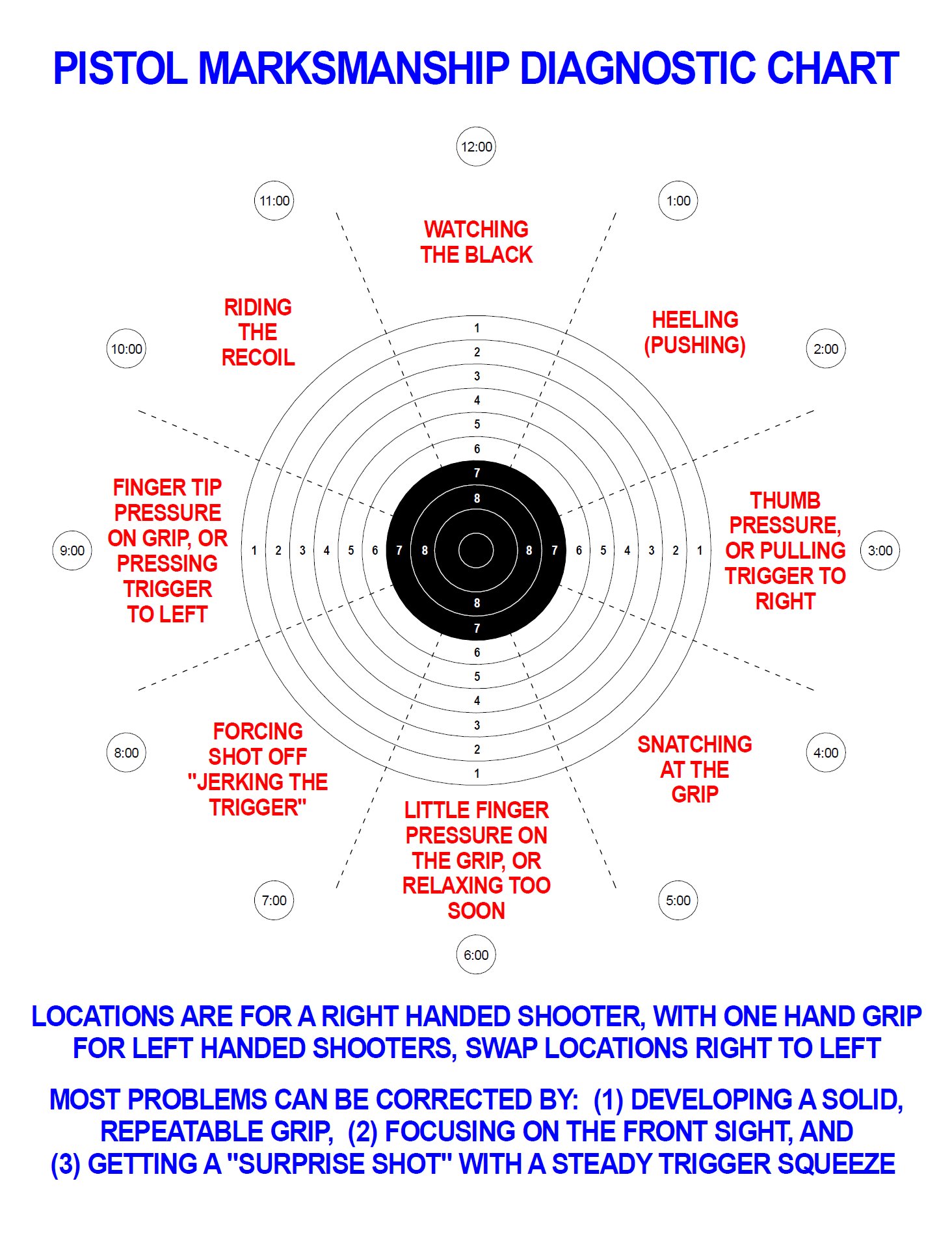

Yes, the trigger finger action can pull the shots at 9:00. In 50+ years of shooting & coaching experience, 90% of the time, 9:00 shots are caused by tightening up the finger tips (assuming you are right handed) against the side of the grip. It's instinctive to tighten up you fingers at the same time you tighten your trigger finger, so you have to train that out of your grip. With air pistol & .22, you do NOT need nearly as tight a grip as you think. You can shoot both perfectly well with your finger tips completely OFF the side of the grip.
I had this issue when I was on the pistol team in college in the early 70's. My coach kept yelling at me to loosen my finger tip pressure. One day he gave up and taped a row of thumb tacks (pointy bits out) to the left side of my grip where my finger tips normally sat. Problem solved... I no longer shoot with thumbtacks on my pistols, but if I get a shot at 9:00, it's almost invariably because my old habits have started creeping back.
The chart you show is not a very good one. Here's the one I use with my students:

For a right-handed shooter, could pivoting the wrist slightly to the left, just prior to discharge, also be a possible cause of those hits? The chart
you posted shows that impacts between 10 and 11 o'clock are caused by "riding the recoil". Please expand on exactly what is meant by this and
how to prevent it. Thank you.
