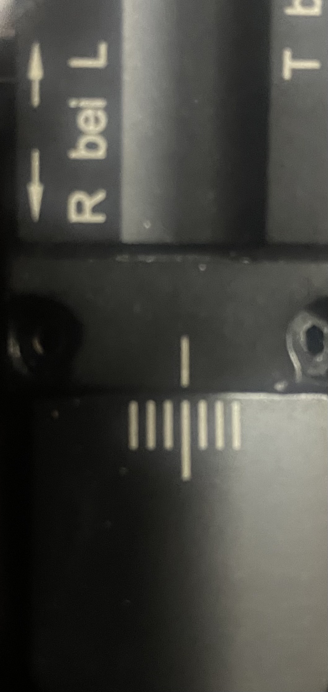

Do you know why is the reason sigths can inclinate to rigth and left(not the shot, the sigth) has show in the picture?
10 meter Shooter
BobGee
Posts: 581
Re: Feinwerkbau P44 Absorber question
Post by BobGee »
Some shooters like to cant/tilt their pistol a small amount. Usually to the left for a right-hander. The rear and front sights can be rotated back to the vertical plane to compensate for this cant.
