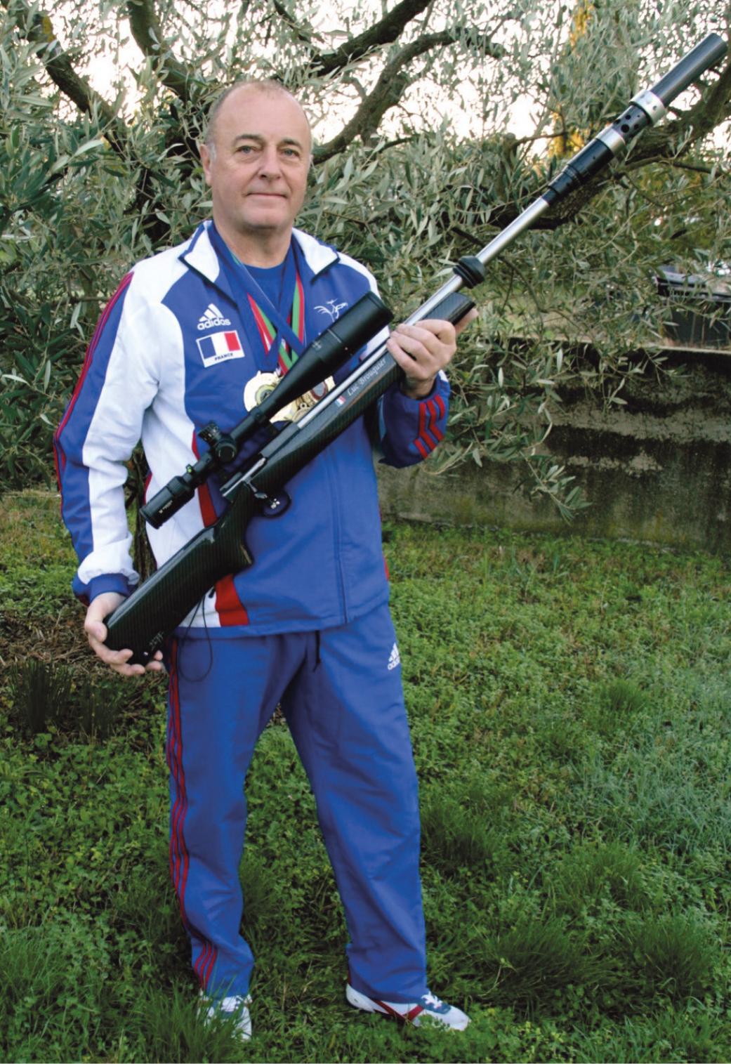

perhaps to prevent this from happening?

Golfshot, what you have there is a BR rifle with a Harrell's tuner fitted with the late J. Pappas extension tube ( with holes ) and a weight system. this was developed after the ISSF rules were put in place, and primarily for BR shooting. I also have some of these, and they didn't work any better than a solid tube. It was a neat idea and Pappas was a great guy with many ideas and he is missed for sure in the BR world.
