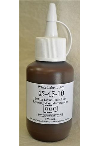

Hey porkchop, what the heck is 45-45-10 lube?
BobGee
Posts: 590
Re: Cast Bullet - Home Lube
Post by BobGee »
Hi porkchop, I've found it: 45-45-10, is 45% Lee Liquid Alox, 45% Johnsons Paste Wax concentrate, 10% mineral spirits.
Not sure what the Australian equivalent is to Johnsons Paste Wax but a local outfit sells the concoction ready-made (for Australian consumption only):
porkchop
Posts: 117
Post by porkchop »
Bob, that's the stuff use thin coats. I like to put 3 thin lines in the bottom of a 2 or 3 liter plastic container and dump in 200-250 bullets. Swish them around until you get a light coat on them for about 3 minutes or more. Spread them on a tray lined with wax paper and let them dry for a few hours or dry to the touch. Then coat them again with another thin coat, this should make them a real thin light gold colour. Then spread them on wax paper again for 12 hours or more, they should be dry and not sticky. With a good load I rarely get any leading and no lube smoke. If you coat them too heavy they'll take longer to dry and harden the coating.
