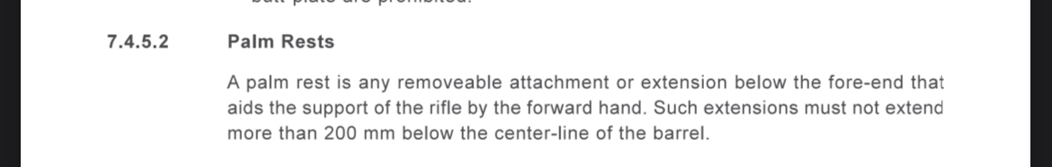

Dumb question, in the ISSF rule book (Standing, g) it says a palm rest is allowed except for 300m and 10m air rifle.
Does this mean that the flat rest under a rifle such as an LG400 cannot be extended below the stock and held by/contacted by the forward hand?
No precision air rifle experience, trying to understand what is allowed or not.

What rule number are you referring to ?
Re: 10m Air Rifle Rules
https://www.issf-sports.org/getfile.asp ... -Rules.pdf
7.4.2.5 The lowest point of the fore-end may not be more than 120mm below the center-line of the bore.

7.4.4.2
D. Depth of fore-end

7.4.4.2
But the rules starting with 7.4.5.* are for the 50 meter rifle.
