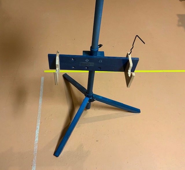

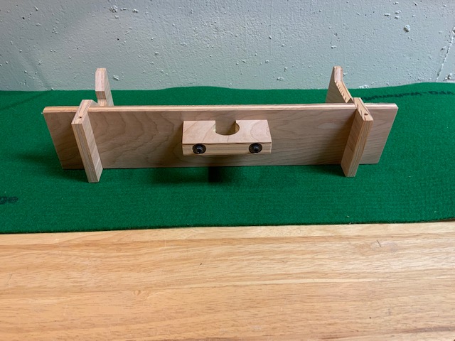

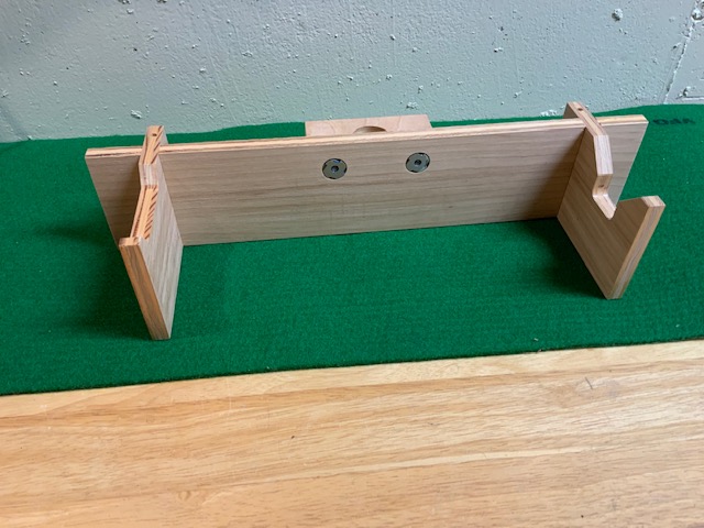

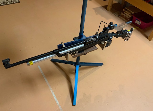

Re: Rifle rest for offhand stand

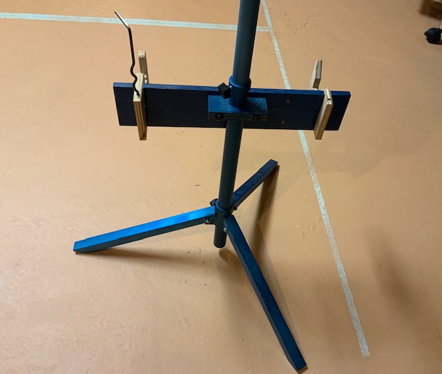

Here are some pictures of the one I built and use. If it meets your needs I still have the materials to build you one. I would ask you to cover shipping.

These holders look simple and solid but the stands themselves always look delicate and unsteady. Are they actually that way or are they more solid than they appear?
The offhand stands are very solid and stable.

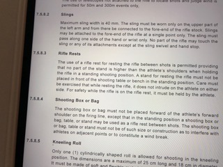

This is ISSF Rule 7.5.8.3 Rifle Rest Rule

I recently asked this question at a CMP event, and it is against ISSF rules. There have been several situations at ISSF events where the stand was not balanced properly and the addition of the rifle caused the stand to fall. This is the rule they will reference in regards to this situation:
7.5.8.3 Rifle Rests
The use of a rifle rest for resting the rifle between shots is permitted providing that no part of the stand is higher than the athlete’s shoulders when in the standing position. A stand for resting the rifle must not be placed in front of the shooting table or bench in the standing position. A kneeling roll may be used as a rifle rest. Care must be exercised that while resting the rifle, it does not intrude on the athlete one either side. For safety while the rifle is on the rifle rest, it must be held by the athlete.
That last sentence is the kicker. Placing the rifle on any kind of holder mounted on the stand, technically, it is still on the rest.
7.5.8.3 Rifle Rests

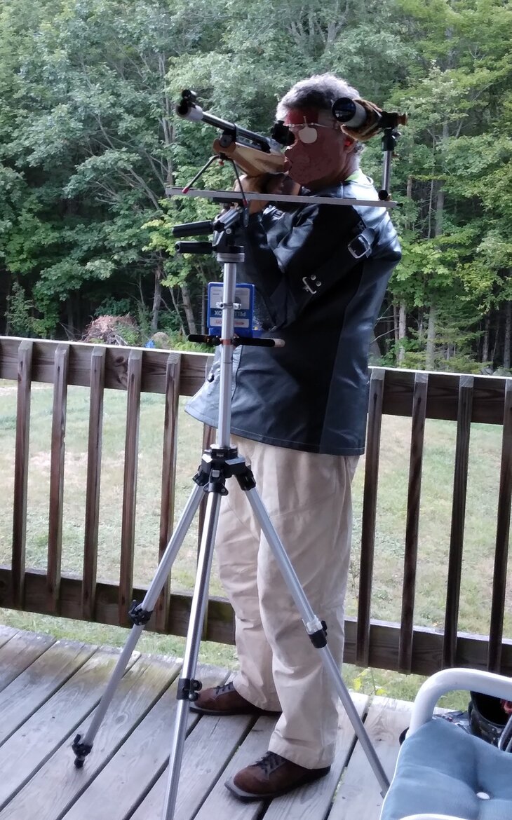

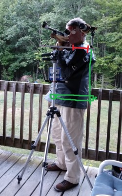

"no part of the stand is higher than the athlete’s shoulders when in the standing position."
Key words here are "When in the standing position", I drop my leading shoulder a bit when in position, states "shoulders" plural, so that no part of the stand is higher than the lower shoulder Or higher than the higher shoulder?
Re reading this, shoulders (plural) meaning both, so the stand needs to be higher than both shoulders to be not proper.
Also questioning, is the spotting scope "part" of the stand?
One possible is that the scope is attached to the stand so it is part of the stand.
Another take would be , the scope is not being used as a part of any support, so it is irrelevant...?
How about, cut the top rest rectangle(red), then mount the spotting scope on a lower portion of the stand? Easily done with an aluminum rectangle and another vertical rod.
Or , first picture, the area where the spotting scope is mounted scope is not being used as a rest, so that area is irrelevant. ...?
