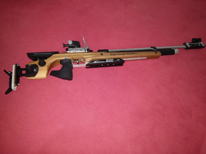

Hello,
I want to get into women's 10m air rifle. I've been stalking these forms and I think I've narrowed down my choice of rifles:
Feinwerkbau 800 Evolution
Anschutz 9015 Club
Walther LG400 Alutec Competition
Walther LG400 Blacktec (is there a difference between this and the above?)
Hammerli AR20 Pro Air Rifle
I want to do competitions, there is a local club I can join, I have a basement range, etc etc.
I'm basically a little overwhelmed on what to get. I was previously practicing with a borrowed Bone Collector .22 break barrel, and I'm ready to get serious.
While we're on the subject, I'm not sure how to tell if I shoot L or R, I can do both with similar results and grouping. So any advice on this would be helpful. I'm right-handed and left-eye dominant.
So TLDR: Which would you recommend for a beginner who wants to get into competitive shooting without having to upgrade right away.

Of those I could go with the Walther or FWB because you're going to get the most adjustability.
Though if it were me, I would go for the 9015 Anschutz ONE 3 Position. Though I am biased because I have one an absolutely love it. Cannot say enough good things. The action would be right at home in an Olympic final and you've got a lot more in terms of adjustability and versatility with the ONE 3 Position stock versus your other listed options. Especially the club models. I outpaced those very quickly when I got into air rifle. I know it is more expensive but its a buy once cry once sort of deal. Depending on where you are located we may be able to hook you up with some local clubs so you can try some of these rifles yourself before you make a big investment. Additionally, keep an eye on the WTS section here. Many fantastic air rifles go up for sale regularly that have been well cared for. It is where I got mine and it can save you some money. I hope this helps, feel free to PM me with any questions. I shot collegiately and I still practice air rifle and small bore on my own. It can be overwhelming but there's a lot of great people here who can help you!
As for the LH / RH split and the cross dominance, its sort of up to you. You could try shooting left handed or shooting right handed and training your right eye to overcome the dominance somewhat. It's something you'll have to try and see what feels more comfortable and what gives you the results on paper. A good coach would help here.

I would say from your list the LG400 Competition but would tell you to look for a good used rifle. You may be able to get a top end used rifle for the same price.

the blacktek stock is basic and of limited adjustability

If price is important, then either Haemmerli AR-20 (I have owned three) or Feinwerkbau 600. If price is not a concern, then FWB 800 of which ever version you want, also the Steyr challenger. If you plan to do 3P, then Air Arms T200.
I used to own a Walther LG400e, it is way beyond my pay grade. I have no experience in Anscshutz Air rifle.
The most important thing you do need is that, where to find a gunsmith that can service your air rifle within reasonable time. If you buy one and find out that the waiting list for service is 3 months. then perhaps you need to think about another brand.
Also, do not forget saving up some money for accessories like an adjustable iris, and sling & jacket if you want to do 3P. Actually get a Jacket anyway.
