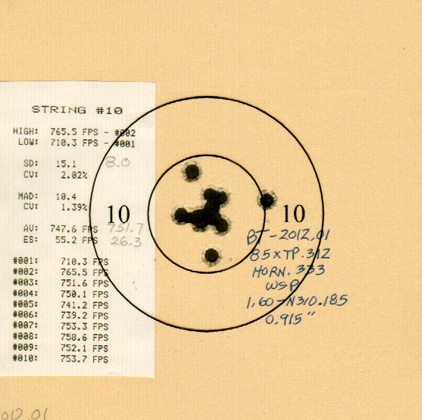

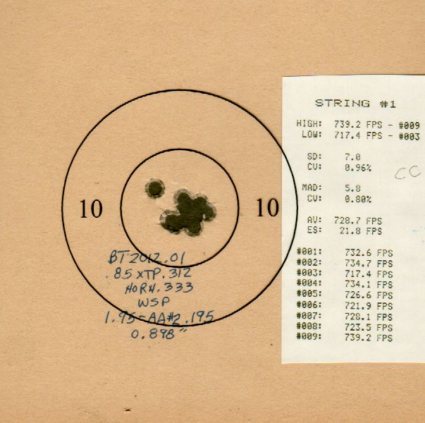

Factory Pardini barrel with Hornady 0.312" 85 grain XTP at 50 yards...
David

Hard to argue with Dave's barrel tester. If you are seriously concerned about your barrel, maybe you can talk Dave into testing it for you.
Dr.Don

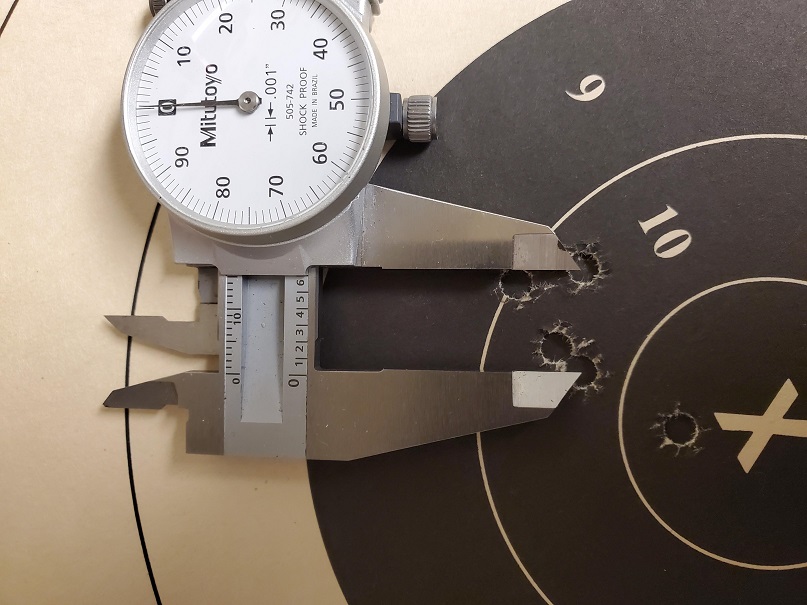

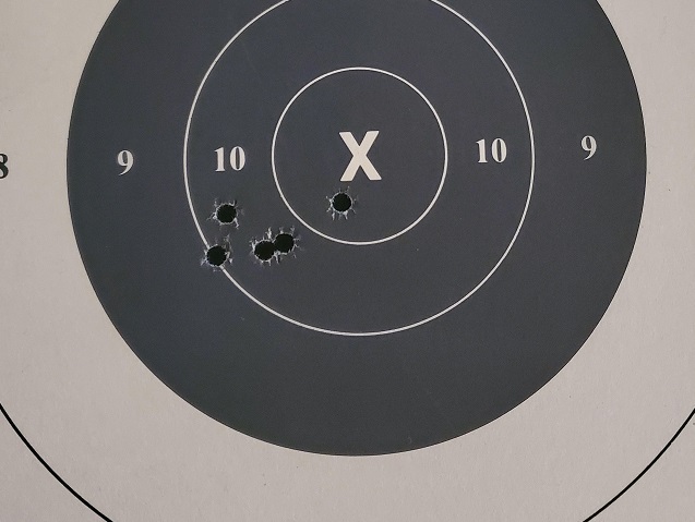

My concern was, is MY barrel in spec. I have seen good groups from a few other Pardini barrels. After what truly felt like a complete waste of a lot of time and ammo one group stood out from the rest. My options were to explore this combination further or start over with a barrel replacement. I decided to go to 5 shot groups to narrow down the best load for my barrel. Surprisingly enough it was very similar to what other were recommending. I spent a lot of time with the dial calipers insuring consistency. I still believe the only difference is all of the latest ammo was built on a RCBS Summit press instead of my XL650. This is by far the best I have seen from my barrel. All testing has been with a ransom rest and at 50yd.Image

The most helpful thing was fc60 encouraging comments and suggesting a beam scale and the single stage press.
1.9 N-310
.875 COL
.332 Crimp
StarLine Brass
CCI Primer
Ransom rest @50yd
Standard Lee 3 die set. I believe they shoot better with the very slight amount of crimp.

Yes i think it helped in my situation. I adjusted the die to the point where the case is smooth/all flair gone, then a 1/8 ish trun lower. This only measures .0005 to no measurable difference but it also shows a very small shiny line at the case mouth. Probably not considered any crimp by most. I shot 10 with this extra squeeze and i believe it was better for me.

Same target. I just like this one more.Image
