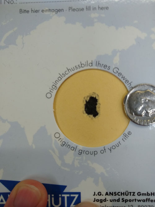

We have a Anschutz Silhouette hunter class with a Lilja barrel that is a tack driver. Under a dime at 100 yards with Center-X. It shoots way better than I can.

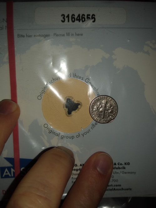

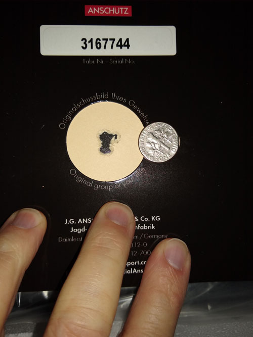

The factory offered these 10 shot groups at 50m from 5430 Factory barrel (not custom Shilen)
Can't control the world, just my aim, well most of the time.....
Re: 3p new barrel - which one? Shilen, Lilja??
For those of us not in the US, how big is the coin? EDIT so a dime is 17.91mm dia. Those groups are nice, but not 7-9mm edge to edge (the smudges at the actual edge not the hole).
Those factory groups were shot with the barrel (no stock) clamped into a vice, and so are not directly comparable to Lapua/Eley test groups where the receiver is held in a fixture and the barrel free floats. The group in the handbook is also cherry picked to the best of my knowledge.
If Anschutz North America's Custom Shop will guarantee ten shot test groups under 9mm edge-to-edge, get it in writing and buy a lottery ticket straight away.

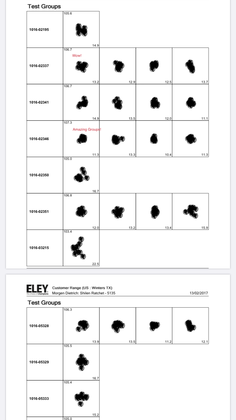

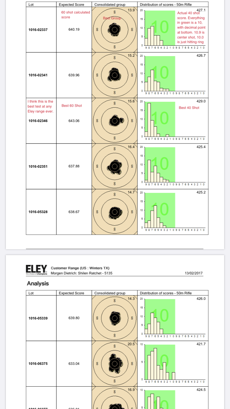

I believe your expectations may not be in line with reality. Here is why?
Eley posted a new range record for a projected 60 shot score of 643.6 yet the edge to edge diameter of that group was 15.6mm over 60 shots. I don't have the 10 shot group best size, you would have to ask Morgan Dietrich.
Here is the link https://www.facebook.com/ELEYUSA/photos ... =1&theater
A Shilen Ratchet barrel. 2/13/2017
From the Lapua side their range record, as shown to me by the person who holds it, was 9.96mm @50M and 17mm @100 from the same batch but 10 shot groups.
Again, a Shilen Ratchet barrel. 8/22/19
So a Shilen Ratchet barrel has set test range records at different places with different ammunition.
7-9mm might be overly optimistic. My best lot of Eley tested to a score of 632.9 with a 60 shot diameter of 18.5. It just barely beat out my Lapua control lot by .5 points over 60 shots. If you can find 12mm-13mm consistency in a test lot, and you do your part I believe you would have the capability to win anything.
