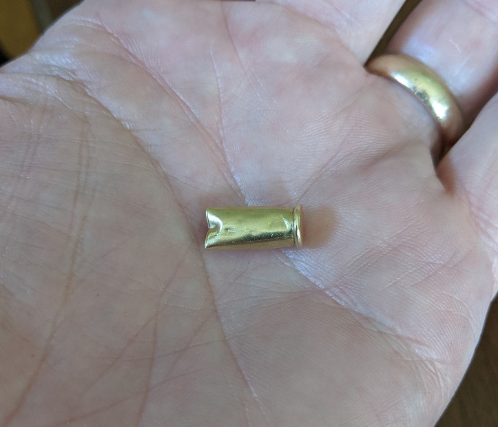

I don't have the .32, but my experience with the .22 is that the extractor can be dislodged by a stovepiped brass in the right spot. When the bolt closes on it, if the nose of the extractor hits the brass it will be jammed backwards. The angle of the nose vectors it outward, these forces combine to rotate it just so and to release it, just like you might do when disassembling it yourself.
Here's a photo of the evidence, from my final shot at Perry this year in fact. 360 shots without an alibi, and this happened after the 360th was launched! You can see the shape of the extractor peened into the end.
