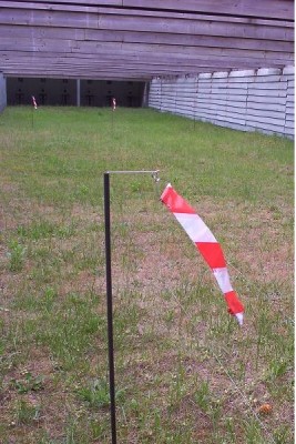

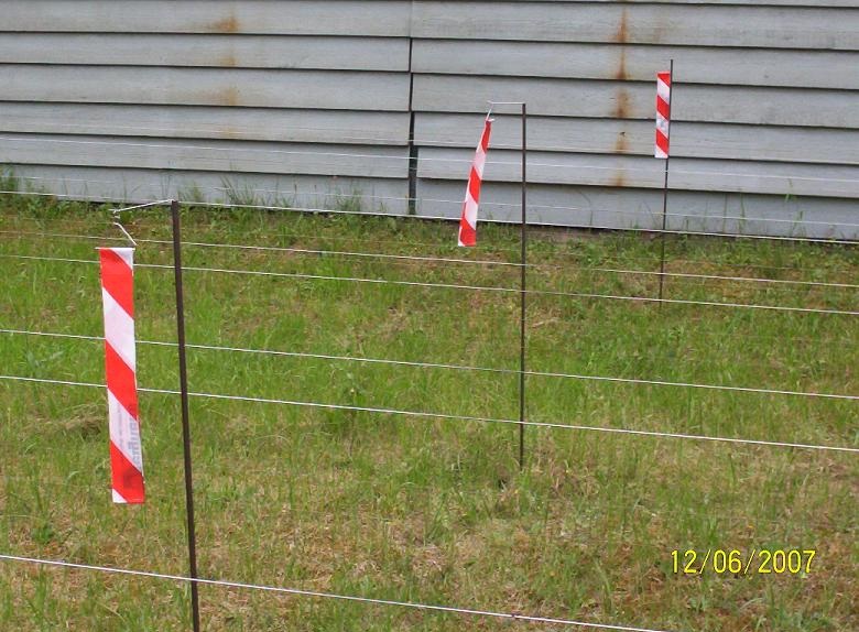

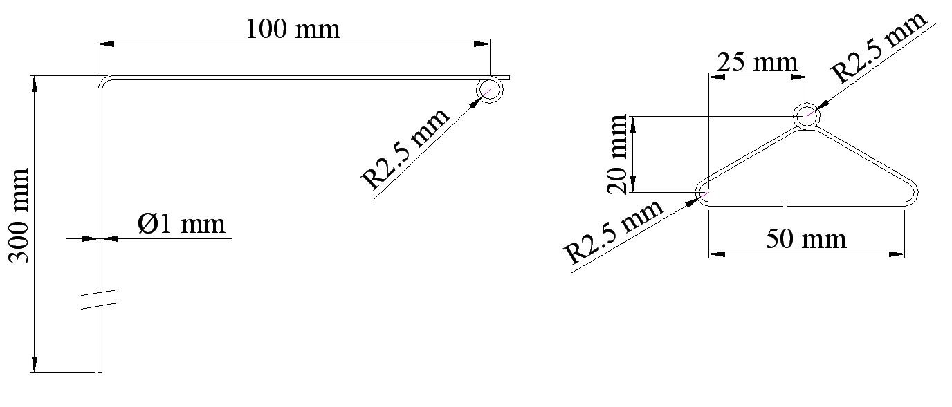

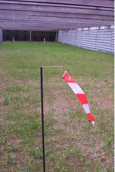

For my club in Haarlem, The Netherlands I made flags using 10mm diameter alluminium pipe stuck in the ground, 1mm Stainless Steel welding wire and seveyors tape cut to a width of 50mm and a length of just over 800mm.
By folding the tape over the swivel in 2 layers, you get the correct lengt and width of the flag. When you put in 2 rows of 5 staples along the long side, evenly devided over the length of the flag you also get the correct ISSF weight of 150 grams/mm2 (or very close to it).
The tape starts to deteriorate after aprox 1 year so you need to replace it after 1 or 1,5 years.
See also attached pictures.
