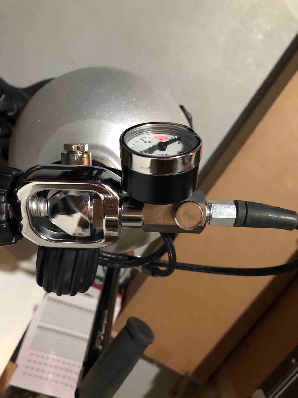

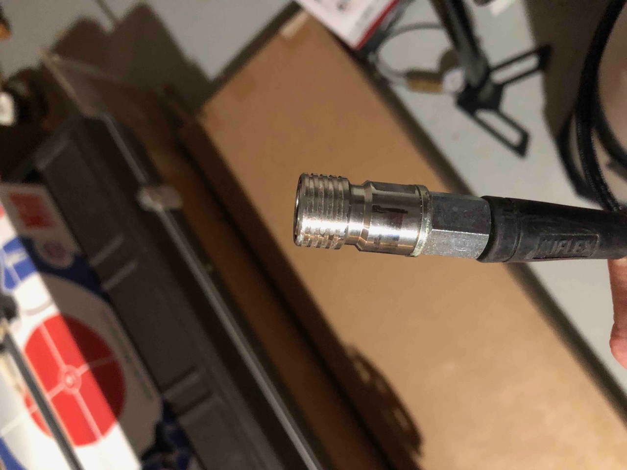

I just bought a Steyr Evo Short. I have a scuba tank and a hill pump. I assumed that the adapter that comes with the gun would work. Now I think I need something else. I have female foster fittings currently on the end of the hose connected to the yoke. What should I get and where ? Thank you for any help.

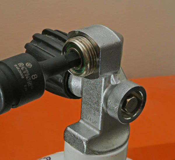

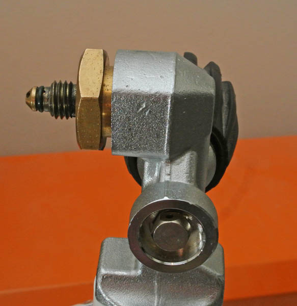

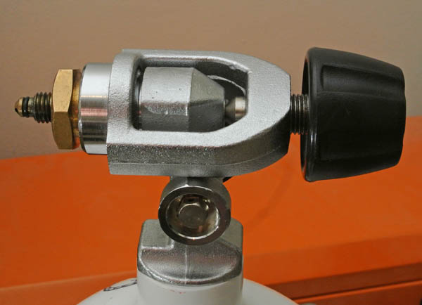

Why not connect onto the yoke fitting or straight onto the tank. Use a 8mm allen key to remove the yoke adaptor to connect straight to the tank or use the Din fitting in the yoke. That is unless you really want to use your hose.
