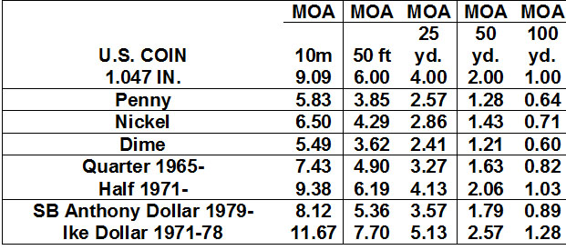

This is similar to a recent post which I could not fully view because my Excel is too ancient. I could not upload an xls file so could not include the various formulas, but included a jpg for those not wanting to download anything. The attached .doc file can be transformed into Excel without much fuss.
In 2013 I began testing the accuracy of several .22 rounds, all fired from various firearms using a steady rest and a good scope. I chose 1 inch at 100 yards for my definition of 1 MOA accuracy, later using 1.047 inches for calculation purposes.
I had become tired of seeing claims like "my rifle shoots quarter size groups at 25 yards!! Hoo rah!!".
I knew that was less than stellar accuracy.
I developed a simple formula of "Coin Diameter in Inches / 1.047 = MOA" to plug into Excel, got the coin sizes off the internet, and voila, a list showing MOA per US Coin Sizes. My friends north of Buffalo can do their own coin sizes, I don't have a loony or a toony to my name...
Details:
*I use 1.047 inches at 100 yards as the definition of MOA; since Excel is doing the math I didn't settle for the easier "1 inch at 100 yards."
*My definition simply says a five shot group will fit inside a circle of the coin's size, with no part of the bullet hole extending outside the circle. This makes for a simple test - can all the bullet holes be covered by the coin, or not?
*There is no allowance for c-to-c, or for actual-bullet-holes-being-smaller-than-bullet-diameter, or anything else. Just one test - does the 3 or 5 shot holes made by the .22 LR ammo fit inside the coin circle diameter, or not.
My spreadsheet, my terms.
As you can see, a dime at 50 yards is the only US coin size that is anywhere near 1 MOA at less than 100 yards, but almost all US coins make a circle of better-than-MOA accuracy at 100 yards.
So if you see a claim of a quarter or a nickel or a dime sized group shot at much less than 100 yards, you can assume the firearm was shooting a little (or a lot) less than 1 MOA in accuracy.

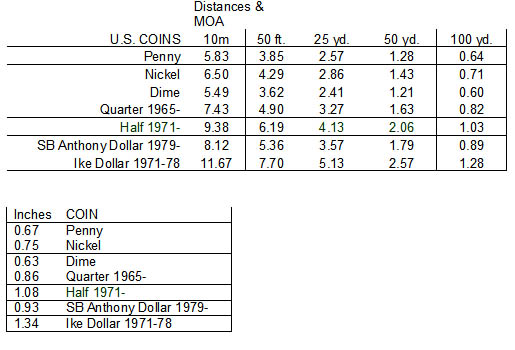

Distances & MOA
U.S. COINS 10m 50 ft. 25 yd. 50 yd. 100 yd.
Penny 5.83 3.85 2.57 1.28 0.64
Nickel 6.50 4.29 2.86 1.43 0.71
Dime 5.49 3.62 2.41 1.21 0.60
Quarter 1965- 7.43 4.90 3.27 1.63 0.82
Half 1971- 9.38 6.19 4.13 2.06 1.03
SB Anthony Dollar 1979- 8.12 5.36 3.57 1.79 0.89
Ike Dollar 1971-78 11.67 7.70 5.13 2.57 1.28
Inches COIN
0.67 Penny
0.75 Nickel
0.63 Dime
0.86 Quarter 1965-
1.08 Half 1971-
0.93 SB Anthony Dollar 1979-
1.34 Ike Dollar 1971-78

Distances & MOA
Inches COIN
0.67 Penny
0.75 Nickel
0.63 Dime
0.86 Quarter 1965-
1.08 Half 1971-
- MOA vs coins 2017b.doc
- MOA per US coin diameters
- (42.71 KiB) Downloaded 406 times

Re: Quarter size groups at 25 yards!! MOA vs U.S. Coin Diame
[quote="Chris__Colorado"]7
If you email me the file, I can post a link and host it in the electronic Airgun Reference Library.
http://www.targettalk.org/viewtopic.php?f=2&t=56517
I'd prefer just to have the jpg file linked, Pilk won't allow xls or doc files, says they are risky.
Download the larger jpg below for better visibility.
At what distance would a US quarter have to cover all the shots, as you described it, to equal 1MOA?
I'm guessing a dime at 63? yards and a nickel at 75? yards.
Your guesses are correct if you choose the less accurate figure of 1” at 100 yds. for 1 MOA. It should be 1.047”, not 1.000”
Coin Diameter in inches / 1.047 * 100 yards = yds. at which the coin covers 1 MOA.
Or, less exact, Coin Dia. * 100 = yds. at which the coin covers 1 MOA.
Nickel coin size .75 inch / 1.047 = .715, then .715 x 100 = 71.5 yds.
Nickel coin size .75 inch x 100 = 75 yds.
Coin Dia. Yds. to 1 MOA
Penny 0.67 64.2
Nickel 0.75 71.5
Dime 0.63 60.3
Quarter 1965- 0.86 81.7
Half 1971- 1.08 103.1
SB Anthony 1979- .93 89.3
Ike Dollar 1971-8 1.34 128.4

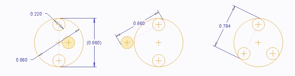

I don't want to criticize the work you've done, but note that I think this can only be assumed 100% true if you only have two shots in the group. In that case, the outer edges of the two holes define the diameter of circle/coin that can cover them, but if you have more than two holes, it can become more complicated.
Take, for example, two 0.22" diameter holes aligned horizontally, with their outer 'edges' exactly 1.000" apart (for round numbers). Now add a third hole above the first two, so the three holes form an equilateral triangle. Any TWO are still 1.000" apart, but to cover all three, you need a circle/coin that is 1.087" in diameter.
Does that make sense, or am I over-thinking it? Or are you measuring groups, by definition, by the circle that can cover them, rather than by the maximum distance between any two shots?
To illustrate my point, I have attached a picture below.
All three examples have a 0.86" diameter 'quarter' and three 0.22" diameter shots on target.
On the left, we have a 0.860" group (3.29 MOA at 25yd) that can be covered by a quarter.
In the middle, we have a 0.860" group (3.29 MOA at 25yd) that CANNOT be covered by a quarter.
On the right, we have a 0.794" group (3.03 MOA at 25yd) that CAN be covered by a quarter.
So if your goal is to say a group that can be covered by a quarter is 3.29 MOA OR BETTER at 25yd, than yes, you are absolutely, 100% correct. But just because you CAN'T cover the group does not mean it's NOT 3.29 MOA or better.
BTW, I came across this statistical look at measuring group sizes that is kind of an interesting read:
http://the-long-family.com/group_size_analysis.htm
It suggests, among other things, that using a group size of four will give you the best approximation for a firearm's statistical repeatability (without having to convert numbers).

marky-d
- Quarter Groups.jpg (43.34 KiB) Viewed 7052 times
Marky-d
No feathers ruffled here, appreciate the different ways to look at things. I can't write 'simple' without a whole lot of effort, and I was in a hurry for these comments, so no doubt it looked like I was in a blather.
You have a fine diagram. It is not what I was trying to illustrate initially, but you pose an interesting and valid point.
The answer is simple, but I have to go feed the cats now. If no one has figured it out by later today I'll post again.
Or maybe I'm the one who is herding cats here, dunno til I get a chance to plug in some figures. Alfred Einstein I ain't; maybe Alfred E Neuman...
