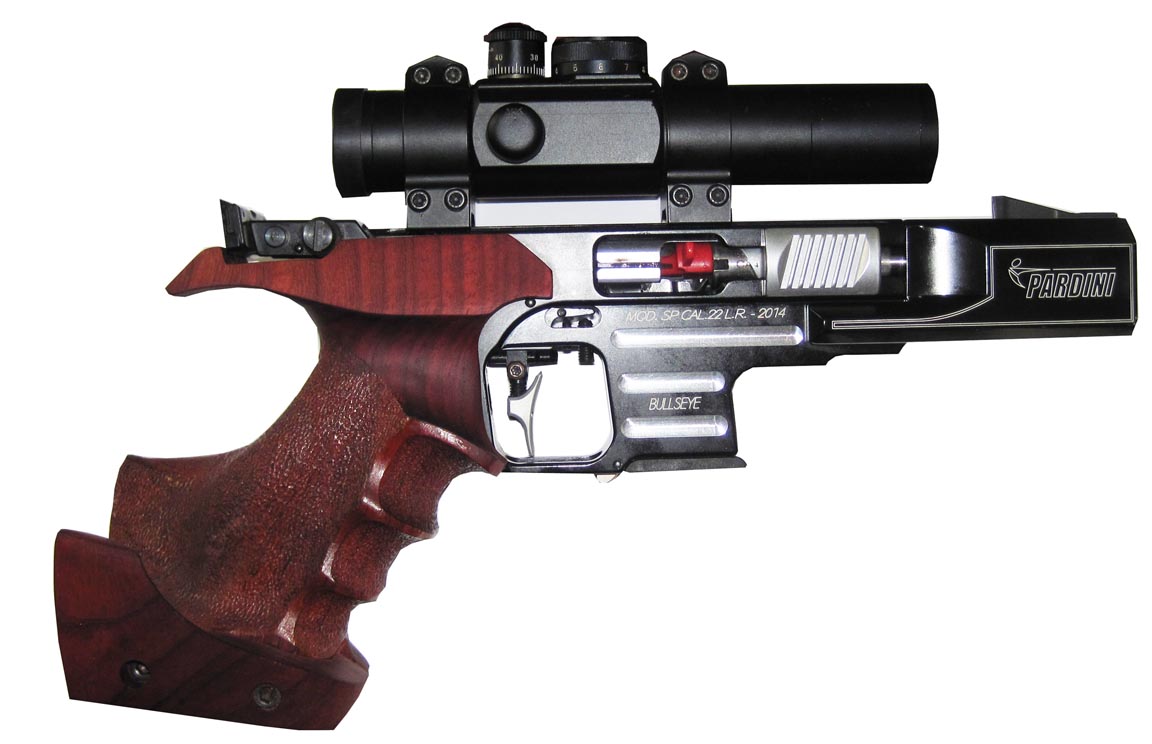

Right up front, I am a fan of the Pardini BE edition and shoot both 22 and 32ACP. It is a very good system, but not perfect IMHO.
The barrel with a short Picatinny shroud is a post hoc fix for American BE shooters to solve the wandering scope ring issue (scope rings do not stay fixed with the recoil impulse of the 32 ACP because the gripping surface, the narrow groove on topside of pistol's frame, are insufficient to fix rings tight). Who would have guessed, especially with 60-grain bullet of the ACP versus 88 or 98 grs with the S&W L caliber?
The best design correction would be incorporating a Picatinny rail into the pistols frame, where the cross-slot feature would forever fix the problem of scope rings failing to hold position under recoil. It could be designed to still use iron sights but have the option of steadfast scope mounting. Maybe sometime.
I've learned to live with scope wandering by ignoring it. I only use the 32 in 2700s; otherwise I shoot a 45 for centerfire 1800s. I have my front scope ring positioned all the way to the rear of the frame groove (see image) which more or less enables me to reposition a moved scope to same starting position. So, when the rings slip, i.e., move about 0.5-inches forward under recoil (only after shooting a 90-round match), the zero isn't significantly changed (but I re-position and re-tighten rings after one match). The rings are Warne low mount Picatinny rings, internal cross-slot bar removed, bottom of feet filed to sharpen inner edge and thence grip tighter (?).
I used to use the 32 for all centerfire stages in 1800 matches, but discovered my 45 skills suffered. However, the little 32 is so fun to shoot in a 2700. Honest be fair, I probably wouldn't buy the 32 today (but I am keeping mine).
I've tried mounting both rings on the front side of the Matchdot II, which had an unexpected consequence. While the pistol was setting on a rest (and I was fiddling with a chronograph and notes), a sudden strong wind gust blew the pistol off the rest, off the range table, where to my utter, cringing horror, it banged off the concrete floor in a sicking thud. (Loud cursing). Remarkably, the gun landed on the bottom rear corner of the grip, cracking it; otherwise, the pistol suffered no cosmetic damage (a few scratches on scope sight-pattern selection knob). Can live with that, but note the new grip.
The unexpected part: having both rings on the front of the red dot and the force of the impact caused the Matchdot II to unscrew (the controls that were on top of the sight were now on the right side). Cursing, cursing, and more cursing. Luckly, I did not lose nitrogen and was able to retighten front part of the scope by turning it counterclockwise.
Maybe accidents this are a senior shooter issue. I don't know. It wasn't even a windy day; hell, it was morning. I heard not the sound of tornado, thunder, or crashing plane; may be the gust was a random puff, albeit a strong one. Pistol netherworld, dipnet

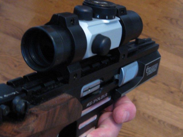

Hello folks,
I shoot a Pardini SP that I bought from Larry's Guns on 5/16/2011.It has a nice weaver or Picatinny rail on top, which is the way it came when I bought it. Are these rails no longer available, or were they something Larry did, that no one else did? I keep seeing all these comments about red dots moving from recoil, especially on the .32 models, and just wonder what the issue is. Mine has over 50,000 rounds through it, and it has the same Ultradot on the rail that was put on it when I picked it up new. It has never lost Zero. I shoot Wolf MT or ME in it, and it easily puts 10 rounds into the X-ring of the standard 50 yard bullseye target. CCI SV can't touch Wolf in this gun, or even Federal 711-B. Serial number is B13xxx. This is my favorite pistol outside of a 1911. It just works, always. Doesn't hurt that it out-shoots anything anybody else shoots at the local ranges:-)
Thanks for educating me on the problems of the latest gen of SP-22! I would like a .32 version if it was set up like mine, with the rail.
Amanda

- Pardini SP-22 wUltraDot MatchDot 30mm 005.JPG (35.28 KiB) Viewed 6115 times
