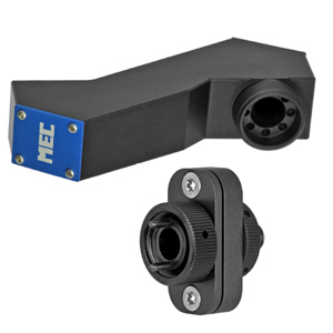

Is anyone using one of these for using left eye and right hand rifle ?The offset sights are too fiddly for different distances.

I am also going to need one of these and would like to hear from anyone using one on a Centra Pro 57 or similar design sight base.

The MEC swap is not so affected by cant as that simple front and rear bracket offset. The MEC with its prisms looks down the normal front and rear sights. Only the iris moves to the left.

Peter, if you're canting to get your head behind the sights, which is the usual reason to cant, periscope sights may allow you to have the gun upright.

yes they are permittes Rule 7.4.1.6 allows any prism or mirror device to swap eyes so long as no magnification is provided. it must be used as intended to swap eyes eg left eye from right shoulder.

Possibly not in my case. This device shifts 65mm but my IPD is 67mm so 2mm extra cant may be required! But I take your point it can give a more comfortable position.

A person at our club has recently started to use a MEC swap, and someone else is getting one also I believe. I haven't used it, but the feedback from those users is that you need to be DIRECTLY and perfectly straight behind the Iris or you dont get a sight picture, or something like that. So it's not like a normal setup where you can be off to one side by a fraction and still have a sight picture, granted in that case you are introducing inaccuracy, but you get the idea.

Does anyone in the US sell this item? Does it adjust width wise? Not everyone has identical eye spacing.

Fixed at 65mm IPD. most people between 60 and 70 but there's a lot of flexibility by canting . youre only looking thru one side!

It doesn't adjust width wise and I don't think it needs to. Not everyone has the same cheek/jaw/eye geometry either, this is what your cheek piece adjustment is for. It will also cater for the eye width variation - adjust your cheekpiece to get your non-cheekpiece behind the MEC swap.

I was fortunate to have the opportunity to buy one of these from another forum member and my first time on the range with it showed much promise. In fact I think this device is going to get me back on iron sights competitively.

That one is to allow the rifle to be held vertically lower. the one for right to left eye swap is bigger.

in my opinion, these are great ! am right handed, right eye going bad (for shooting), left eye dominant, 75 years old.... am shooting with this and scores have increased substantially. it simply screws into your rear sight so all your position settings remain the same. there may be a used one for sale on this website. regards using the left eye after years of using right eye.... took about three or four shots to feel comfortable.
