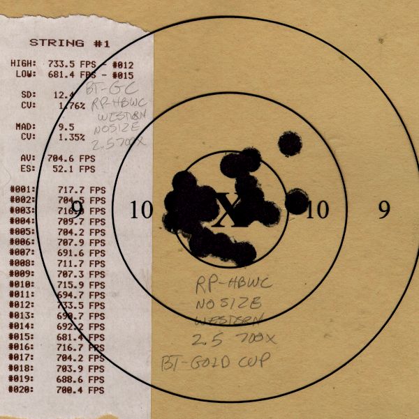

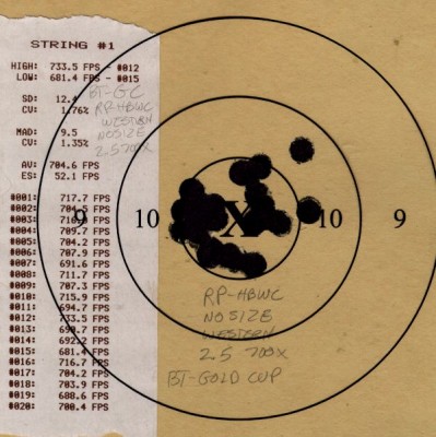

Greetings,
I have Colt National Match MK III as well.
It is a blow back pistol so there are more accumulated tolerances to deal with.
From a barrel tester, the barrel is quite accurate. The target image attached is the barrel in a fixture fired at 50 yards.
I did Random Rest the pistol many years ago with the H&G #50 cast bullet. It shot three inches at 50 yards.
Someone has gone through my gun as the rails have been peened and a new barrel bushing installed.
