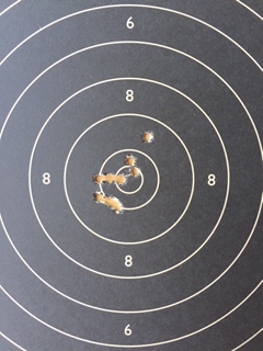

I've attached two targets I shot yesterday at 100 yards, Lapua Midas +. Looking at the group size do you think I'd benefit from using a Starik tube?

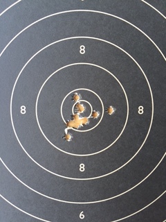

Bryan,Bryan996 wrote:Looking for advice from people who use tuners.

Bryan, maybe I missed it but what rifle are you shooting?
Ed is correct, with good ammo you should expect 10 shot groups inside one inch at 100 without a tuner. You could also try adjusting the receiver bolt torque before you buy a tuner.

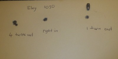

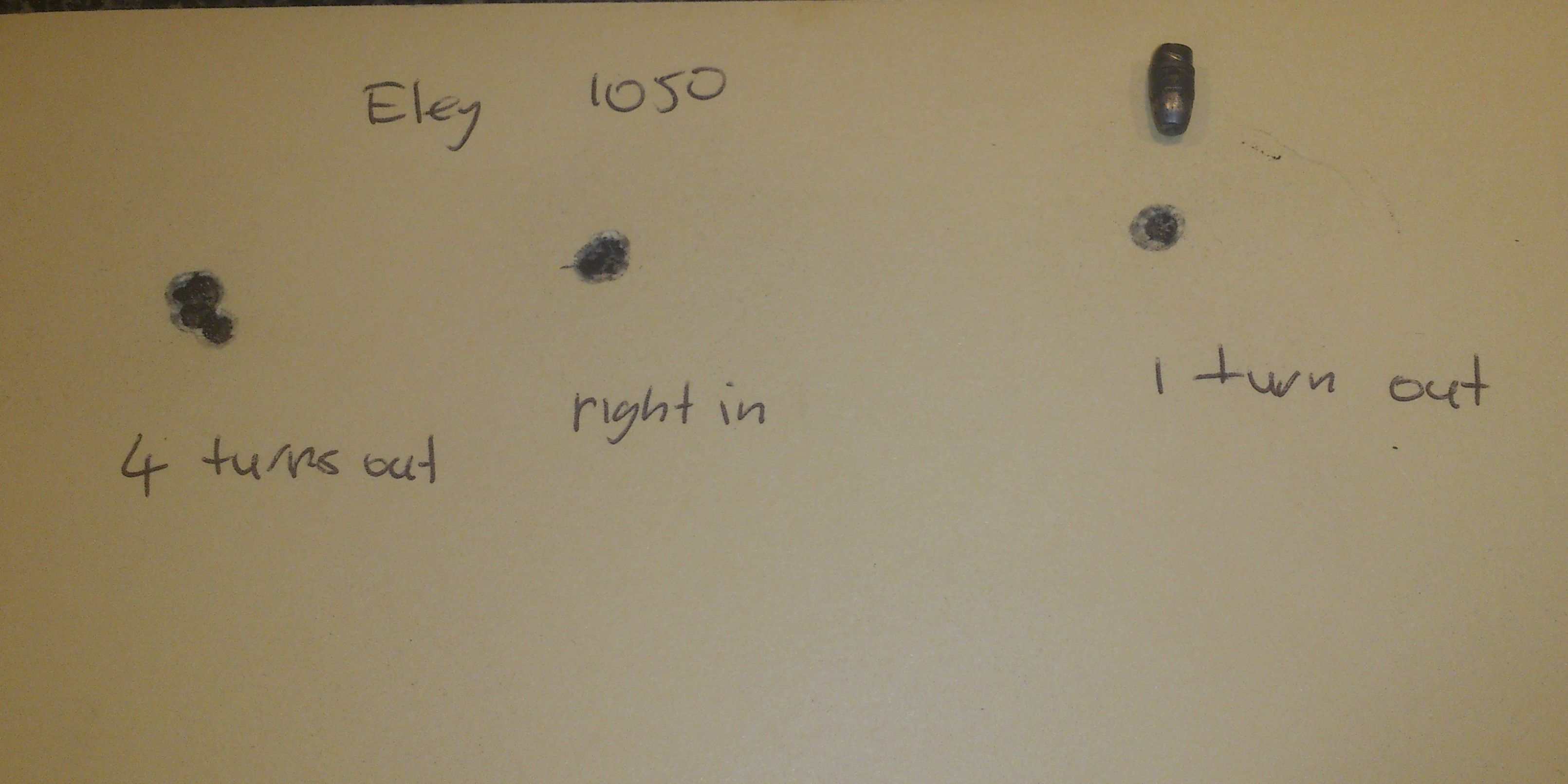

20 yard with Starik tuner.10 shots in each hole.My rifle has never grouped like that before i fitted the tuner.

Thanks for the replies, let me fill in a few blanks.
This is an Anschutz 54 action thats been fitted with a truflite barrel (good memory Tim) and is fitted in a precise stock. The barrel has now had 2640 rounds through it. I bought Lapua as Eley didn't recommend batch testing with them until I'd reached 2000 rounds but I had competitions to do and needed ammo and Lapua were offering free batch testing local to me. I bought some Midas+ and centre X. I was visiting another club on sunday specifically to sight in at 100 yards for a comp I have next month and shot both the Midas and the centre X, the Midas was clearly the better performer as you'd expect. I'm also confident that the barrel has improved since around 1500 rds.
The targets were shot from the shoulder with iron aperature sights. I started reflecting on the targets when I got home as I dont often shoot at 100 yds (once a year) and I think the group pattern reveals more than 50 yards does. I recently came fifth in a comp with a score of 611.9, the winner scored 626.4 (UK's top .22 shooter Kenny Parr) but silver was 618.9. That score gave me an average of 10.2, if I could have scored an average of 10.32 I'd have taken silver! That leads me to thinking about all the possible options to improve and tighten up my groups. Hence the tuner.
