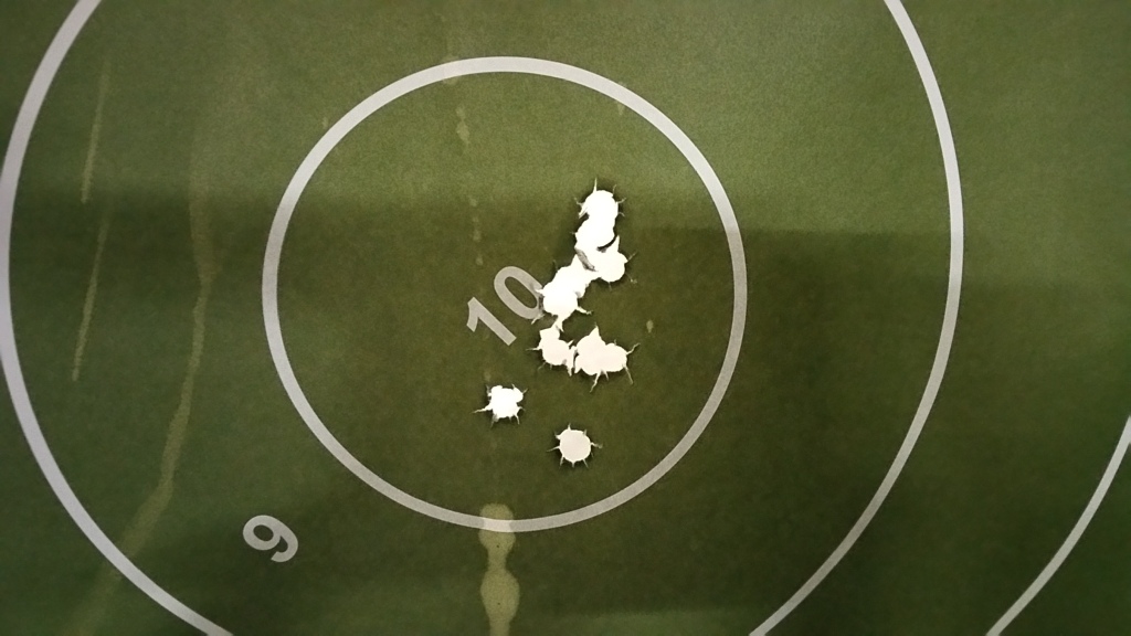

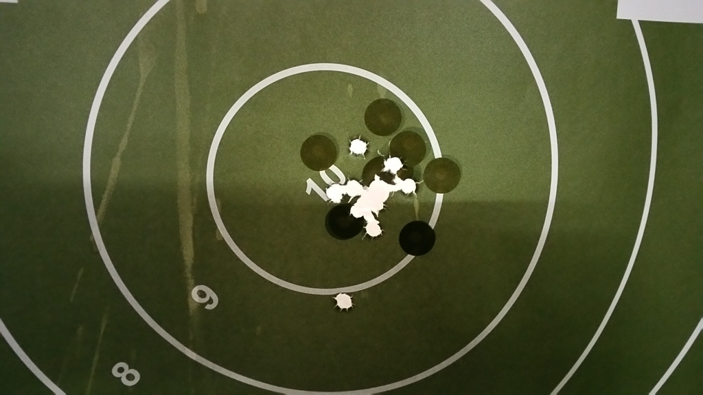

Hi guys from Czech Republic,
I am new owner of GT9. I got this beast 14 days and I hopefully find accurate load.
1. Slovenian bullet LOS 123gr HP (copper covered lead) over 4,1gr Vihtavuori N320, light crimp
2. Same bullet over 4,8 Vectan BA9, crimped a bit more
Pics included, shot on 25 meters.
Hope it helps.
