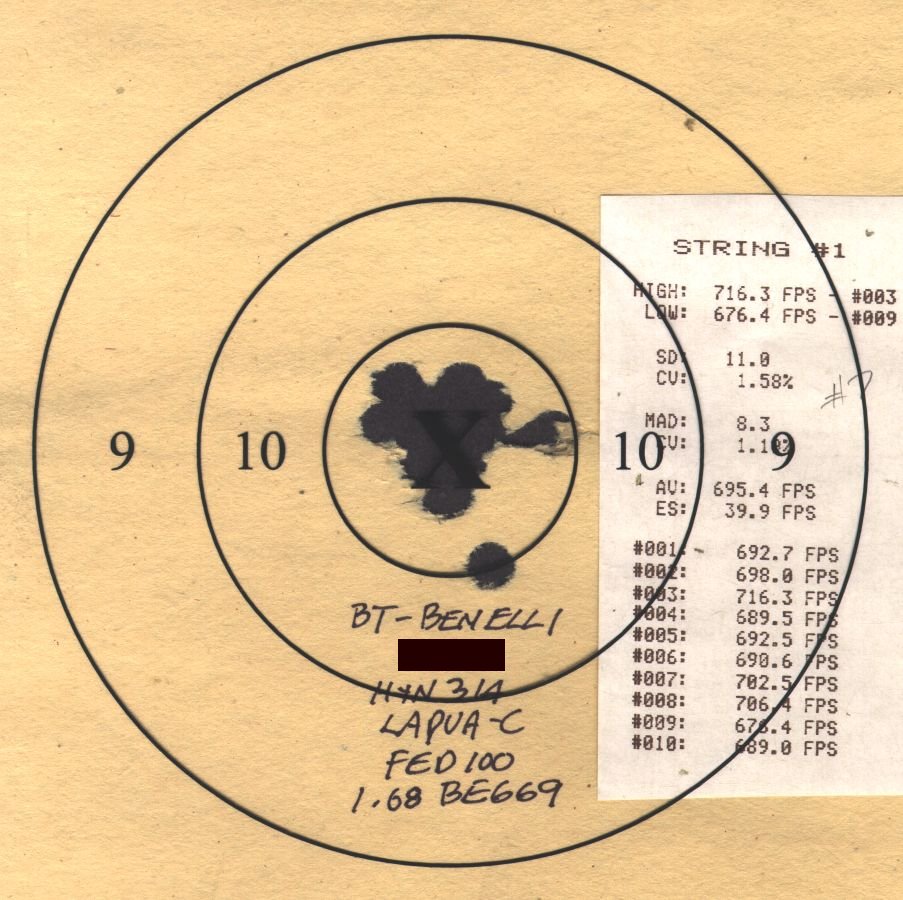

Greetings,
Attached is my best test target with a factory Benelli barrel. (50 yards, barrel mounted in fixture.)
The ammunition is key!
Patience and attention to detail prevails.

Re: Load for .32 S&W Long
Fantastic target at 50 yards, Dave! Which powder and how many grains did you used?
1.68 grains of Bullseye, Lot #669ser2711 wrote:Fantastic target at 50 yards, Dave! Which powder and how many grains did you used?
Remember, accuracy comes only from repeated testing of your components.
I have obtained X-ring groups with Bullseye, 231, VV N310, VV N320, and other powders. The best bullet I have tested is the 100 grain H&N, which is becoming impossible to obtain due to the UN Arms Treaty restricting export/import.

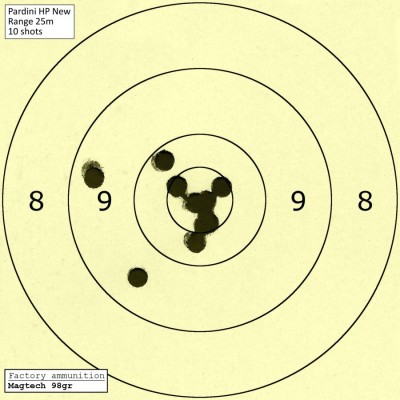

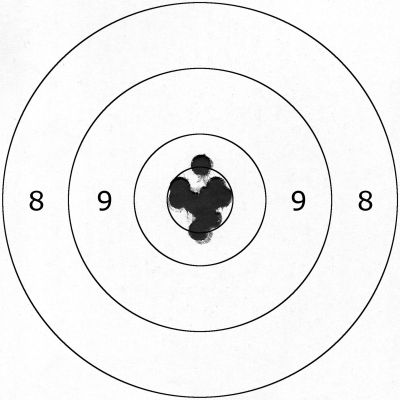

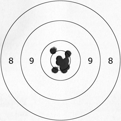

With Dave's invaluable support I've managed to produce such a load: Lapua case, CCI primer, VV N310 1,39gr, H&N .314L bullet. Though I tested it on 25m distance only the results look quite promising in terms of potential performance on 50yds.
I tested my rounds with Pardini HP supported on a sandbag with a scope mounted. 10 rounds, 25m.
- Lux2.jpg (28.45 KiB) Viewed 6033 times
- Lux.jpg (26.03 KiB) Viewed 6033 times
Greetings,
Thanks for the images.
Scanned targets say much more than words.
When I test off sand bags, I use a Burris 7X pistol scope. At 50 yards, I hang a target backwards, white side out, and place a one inch black square paster in the middle. Align the crosshairs along two edges such that you are aiming at a corner. When the shot releases, you know quickly if you moved. Since the paster is one inch square, it reduces your hold error considerably.

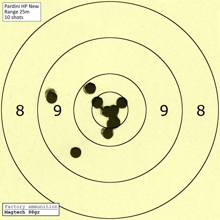

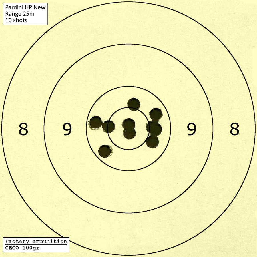

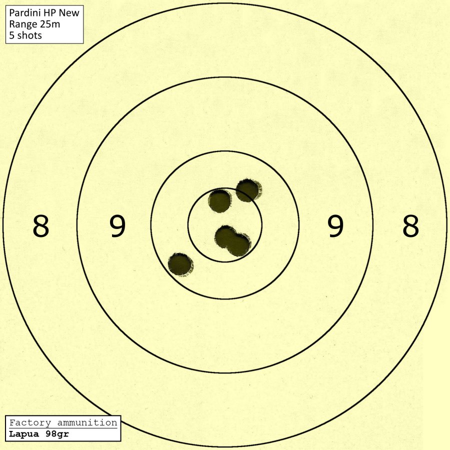

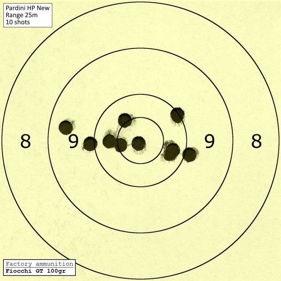

I tested several factory ammo batches with rather average results (maybe except Lapua). Here are some samples, again at 25m only.
