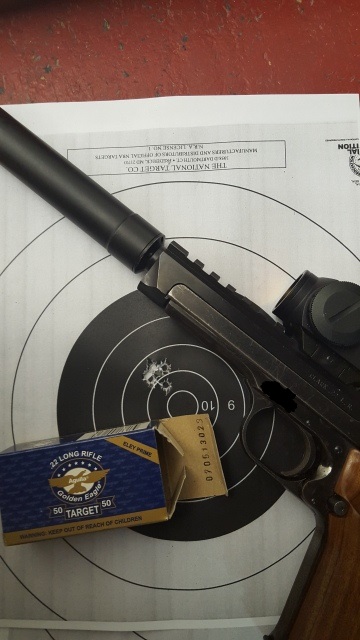

What is that on the barrel? what ever it is it is not legal for true nra bullseye matches, as for the high standard, they do good if it functions a 100% but most have feeding issues with the mags.

GunRunner wrote:What is that on the barrel? what ever it is it is not legal for true nra bullseye matches, as for the high standard, they do good if it functions a 100% but most have feeding issues with the mags.
That is my AAC Element.
http://www.advanced-armament.com/ELEMENT2_p_437.html
It is the best money I ever spent on anything gun related. Hollywood quiet on the right host. The relatively heavy steel slide of the 41 and the impact of the bullet are by far the loudest parts of the equation.
For a match, I take it off and screw on the thread protector - but I assure you if you played with it, you'd come away thinking anything less isn't a civilized affair ;^)
I intend to give the HS a chance. If it isn't for me, c'est la vie. I haven't tried it with CCI SV, which would probably be a smart place to start.

I'm not sure what the question is. You have a model 41, its a good gun and I'd use it for .22 comp.
your barrel is a mess though. Why are you worried about noise?

Exactly how does the suppressor make that gun not bullseye "legal". The only thing I can think of is IF the combination of the suppressor and the barrel are over 10 inches AND it was determined that the suppressor was considered a "barrel" under the rules then it would not meet the definition for "open". Barrel comps are legal for conventional, excuse me "precision" pistol and I assume that if the shooter is legal as far as the suppressor ownership goes, then it would be ok for competition.
Can anyone point me to the rule for comment in Gunrunner's post?

drop the silencer on your 41 and get it fixed where it will be reliable and you're done.
