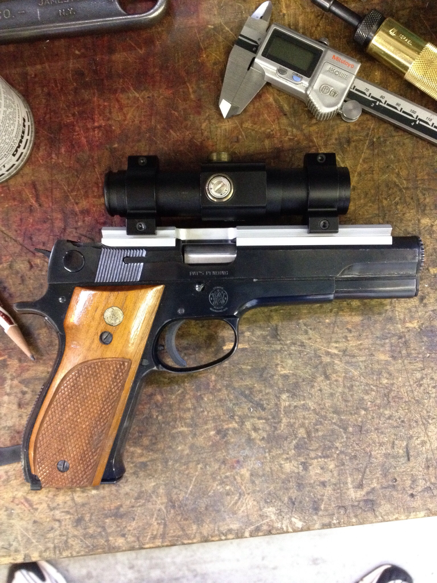

Roger, it looks like BME makes a variety of mounts for the Smith and Wesson Model 52. Did you see the picture of the mount, a friend machined for his 52?
- Jerry Keefer

David Sams style frame mount...
But as Isabel points out, it is "possible", marginally so, to slide mount.. With the new Aimpoint Micro, it is probably easier than it has been to get proper cycling and function..

I noticed that pic in another thread. It looks clean without the extra recoil grooves and your friend did a nice job on it. I'm considering getting the cutter to make that kind of mount in my shop for other guns, but I still would really rather not drill holes in the 52. Maybe I'm taking the whole "classic" thing too seriously ...

Very pretty Jerry. If I didn't already have a very nice 9mm for Centerfire (with a SCG frame mount) I might try that.

Very nice. Classic or no, that would definitely enhance the value of the gun, especially the part that says "Keefer Custom".
However, since getting my gun Keeferized is not likely and a slide mount in the rear sight dovetail may not work, I am leaning towards the BME S&W52-BWR which mounts to the grooves normally used for the barrel weights.
